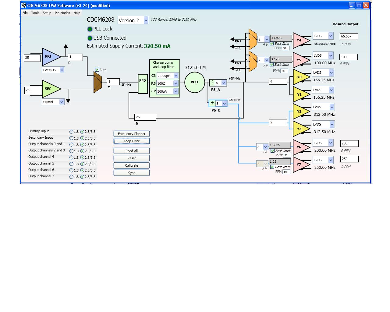

Hi All,
We are unable to configure the device in I2C mode as it is not acknowledging. We confirmed it through probing on the clock and data pins. Even the default outputs are absent. we could able to see some DC shifts on the CLK output pins (1.8V DC on CLK_P and 3.3V on CLK_N pins). We tried to program it from FPGAs (ARTIX  and SPARTAN).
Even the PIN mode is not working for us. Same is the case with outputs in PIN Mode.
Please find the attached schematic file and clock synthesizer loopfilter and frequency planner images7658.TCC_SCH.pdf

    - are you using CDCM6208 version 2 as the capture shows, VCO ferq is differnt?

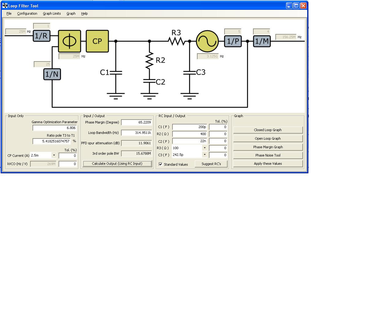

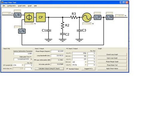

    - the CP current is inconsistent between the two figures (500u or 2.5mA), which one is used?
    - is SI_MODE[1:0] set to "01" for I2C mode, and left open or set to "10" for pin mode?
    According to the schematic attached, CLK_SYN_MODE[1:0] = "00". this actually sets the SPI mode instead
    This anyway has to be fixed before being able to communicate using I2C or set pin-mode
    - is the AD[1:0] set to the address used by the host for the I2C mode?
    According to the schematic attached, CLK_SYN_AD[1:0] = "00".
    Please do those simple checks first and let me know the results.
