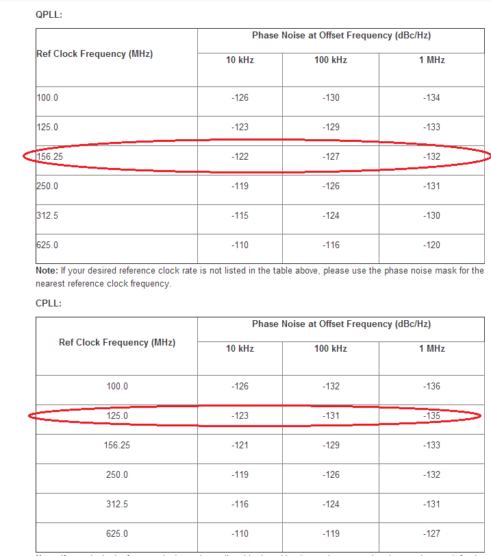

The 125Mhz and 156.25MHz jitter mask is attached below:

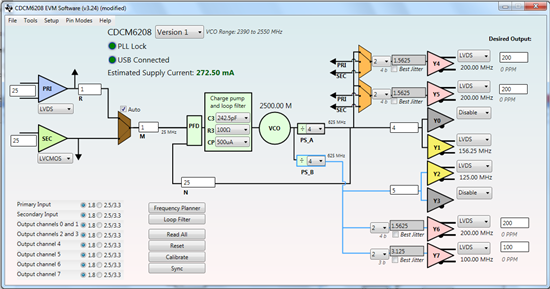

  • Hi Eli,
    you can try CDCM6208, it could generate all your necessary clocks with a 25MHz crystal. See attached configuration.

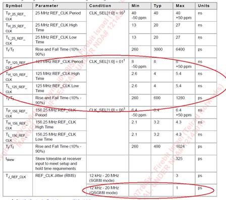

  • 1)Dose the outputs meet the requested jitters?
    2)PHY: 125MHz as follow:
  • Hi Eli,

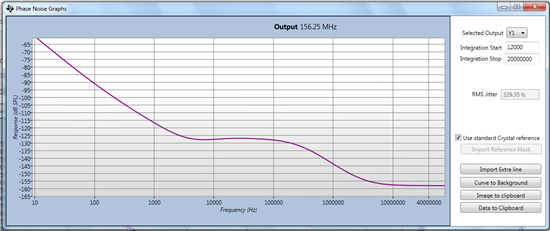

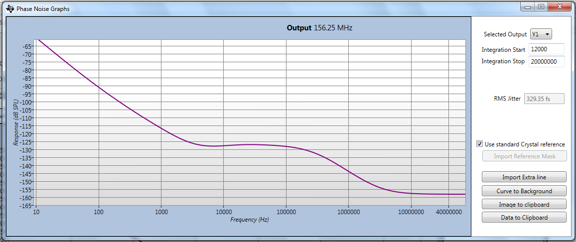

    Yes, we are able to meet this jitter requirement with lots of margin. From datasheet page 19, Figure 2, you can see the jitter for 156.25MHz output is just 263.7fs rms. The jitter will be similar if the output is 125MHz.
    It look good for 156.25MHz.
    At 100k offset it is about -132dBc/Hz for 156.25. For 125Mhz this figure will be higher, and might be above required -131dBc/Hz.
     Could you get a plot for 125Mhz?

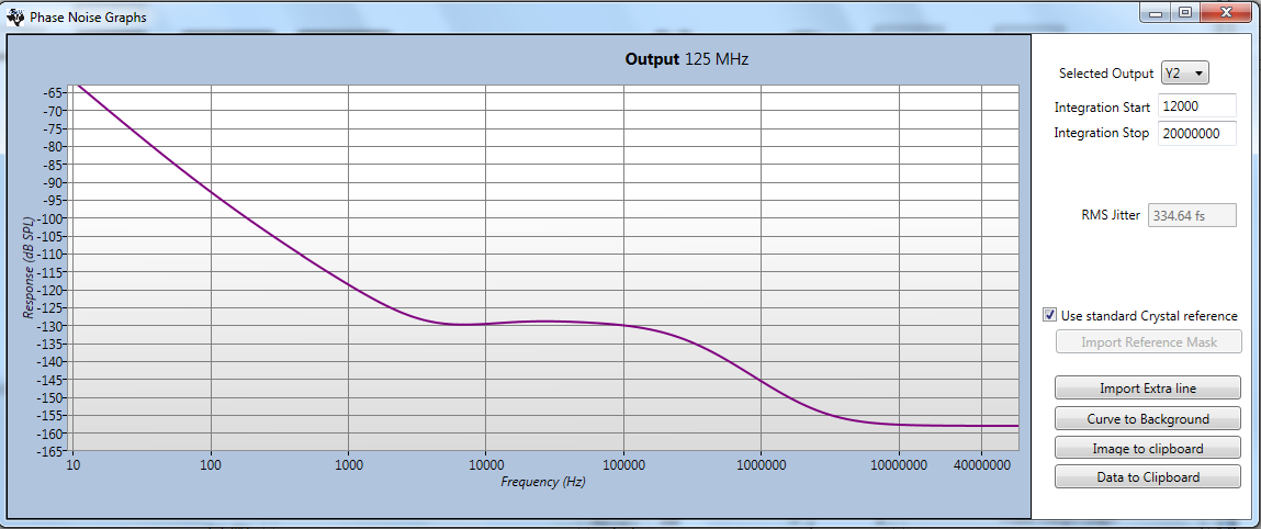

    See below and advise:
    This is the plot I got. I rather use the integer divider for lowest Jitter.

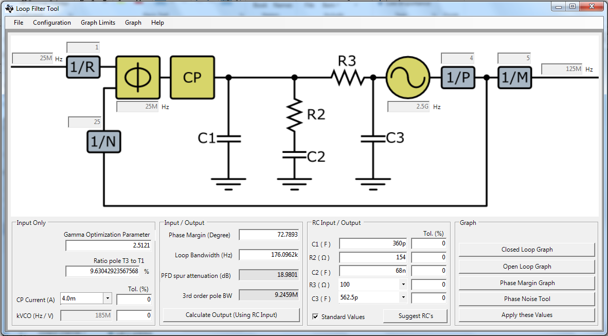

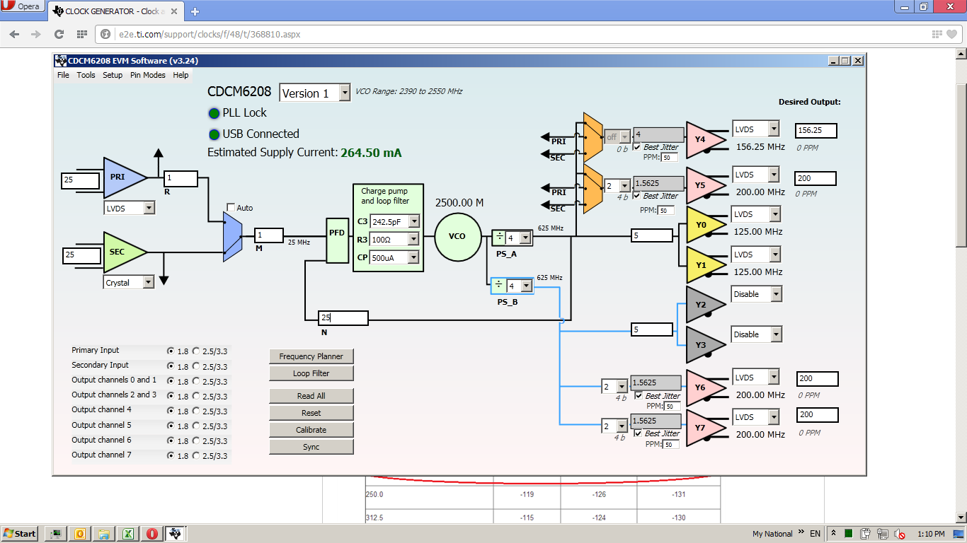

    I need help with the Loop Filter. I used following values (be below) and got Phase noise figure Marginal for 125MHz at 10K offset.
    Ignore the 200Mhz, I need the 200MHz for DDR prior to CDCM6208 configuration.  (couldn't find this frequency at pre-configuration options).
  • Hi Eli,
    Suggest use higher charge pump current and wider loop bandwidth. For example, use 2.5mA CP current and set the loop bandwidth to 400kHz. Phase margin equals 70deg is fine.
    Below is a plot also with 25MHz crystal input, 125MHz output that we took a couple of years ago. At 10kHz offset, the phase noise is close to -135dBc/Hz.
