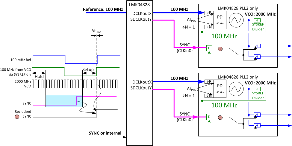

    I do want to put a second option out on the table for you, as it may simply your design.  See image below.  It does run into some of the same questions of setup and hold time though, however I have a quick answer for you below...
    Provided you have clean signals, you don't really need jitter cleaning from a VCXO or frequency multiplication of PLL1 to give PLL2 a nice high phase detector frequency to operate with...  In this case you can configure the device to operate in 0-delay PLL2 mode with the SYSREF divider taking the place of PLL N.  This will ensure that all the SYSREF dividers are aligned by 0-delay.  Then you can use the D flip flop clocked by the SYSREF divider output to re-sync an external signal.
    Now you can see with SYSREF_MUX = 1 (Re-clocked SYNC mode), the signal providing the re-clocking is going to share that same phase alignment between all the other LMK04828 devices within phase detector error.  This puts the burden on you to send a SYNC signal coherent to the phase detector frequency of PLL2 (meeting setup and hold times).
    I did a quick measurement on a system with a 122.88 MHz PDF (vs 100 MHz in illustration below) and found I could make adjustments from an upstream LMK04821 device (note LMK04828 shown in image below).  Using VCO1 = 2949.12 MHz and VCO div = 4 to increase the DDLY steps size to 1.35 ns per step on upstream LMK04821 I found that I could set DDLY step = 3, 4, 5, 6, 7, 8 of upstream LMK04821 device and keep the same phase relationship.  This suggest that given the 8.14 ns period of the phase detector/D flip flop re-clock that 6.75 ns span resulted in same position.  Hence the step+hold time is less than 1.39 ns.
    Note: key to use CLKin0 for SYNC/SYSREF input for improve setup/hold times.  This may not work with CMOS SYNC pin.  Also, CLKin0 is better to use as SYNC pin can cause some crosstalk onto VCOs of LMK0482x when toggling.
    In test I did:
    • Reference frequencies were 122.88 MHz, not 100 MHz.
    • Upstream device is LMK04821 with VCO1 = 2949.12 MHz and VCO_DIV = 4.
    • LMK04828 downstream PLL2 operated at 2949.12 MHz.

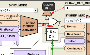

    If you chose to setup this, note the CodeLoader software has an error in the diagram on the SYSREF tab.  See correction in red below.  Point is CLKin0 can drive D ReClk FF input.
