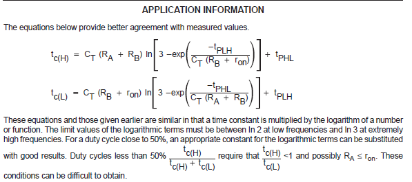

Hi TI,
The LM555CN timer works based on the following linear relationship: F = 1/T = 1/(C*(R1+2R2)*ln(2)). I just wonder what the linearity range of this relationship is? In other words, what is the maximum and minimum capacitance and resistor values that allow the above equation to hold.
