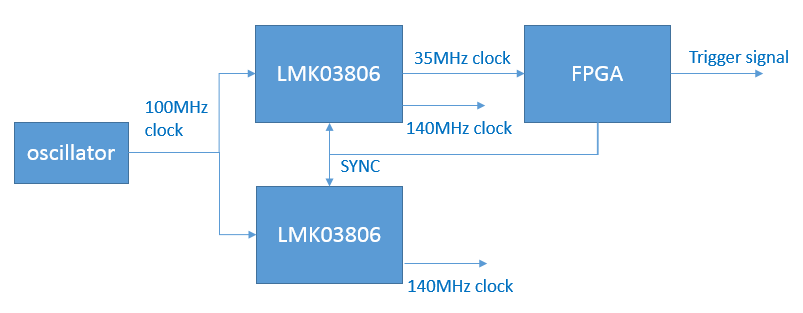

Hi Sir,
Below is a diagram of my design, as you can see I use the same FPGA pin to assert the "SYNC" signal of two LMK03806, so I am expecting the two 140MHz clock output are synchronized both in frequency and phase.
However, when I use the "Trigger signal" from FPGA as the triggering channel of oscilloscope, and measure the 140MHz clock from two LMK03806 separately, I found the 140MHz clock of the 1st LMK03806 synchronizes with trigger signal perfectly, however, obviously a ~0.4ns jitter can be observed on the 140MHz clock of the 2nd LMK03806.
Since the VCO inside LMK03806 is set to 2500MHz, 0.4ns is close to one clock period so I suspect there is something wrong on the SYNC mechanism, appreciated if there is any way to solve this problem, thanks !
Hi Timothy,
I presume that if you triggered on both 140 MHz clocks, they would been phase and frequency locked without jitter?
>> yes, if I measure the 140MHz clocks separately, the 0.4ns jitter is gone.
I presume that the trigger is occurring multiple times giving the visualization of the jitter of 0.4 ns?
>> yes
The SYNC of the LMK03806 will cause all the dividers on the single LMK03806 to reset. However the timing is not such that you could have assured phase relationship from LMK03806 input to output, or from LMK03806 to another LMK03806 less than a VCO cycle. Now the timing will be close. But it could be, as you have seen, a VCO cycle - perhaps even two off in timing over PVT.
>> Do you mean the frequency of both 140MHz clock is the same, while their phase may deviate about 1 or 2 VCO cycle ? But if this is the case, on scope when I trigger the first 140MHz clock and measure the second 140MHz, I should not see jitter between the two clocks, instead a constant delay(1 or 2 VCO cycle) should be observed, though which is not the case in my measurement.

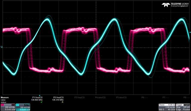

blue : the first 140MHz clock (sorry I use a normal probe on this channel so shape of waveform is highly distorted)
pink : the second 140MHz clock, a 0.4ns jitter can be observed with respect to the first 140MHz clock
And thanks for the information of 0-delay mode of LMK04806, I will consider it.
Nate.Wang said:>> Do you mean the frequency of both 140MHz clock is the same, while their phase may deviate about 1 or 2 VCO cycle ? But if this is the case, on scope when I trigger the first 140MHz clock and measure the second 140MHz, I should not see jitter between the two clocks, instead a constant delay(1 or 2 VCO cycle) should be observed, though which is not the case in my measurement.
What I mean is that from power-up to power-up there could be a cycle error. Once locked, the phase will be fixed and constant.
Another possibility for you is the LMK0482x or LMK04832. There is a way to use it without dual loop had have deterministic phase from power-up to power-up. It has a SYSREF divider which can be used for 0-delay. The divided SYSREF signal also clocks a D flip-flop which can have it's input driven by CLKin0 or SYNC (I suggest using CLKin0 for better timing). This allow you to provide a 'SYNC' signal to the device which will be re-clocked by a lower frequency signal (SYSREF) that now has a phase relationship to the reference provided to OSCin because of 0-delay, this allows you to have divider reset determinism. If you provide the a rising clock on CLKin0 on a falling edge of OSCin, then you can have your CLKin0 sync re-clocked onto the SYNC path and reset the dividers in multiple LMK0482x or LMK04832 devices at the same time.
For cases where PLL2 R does not reduce to 1 with respect to your frequencies, the LMK04832 also allows synchronization of PLL2 R divider (and PLL1 R divider).
