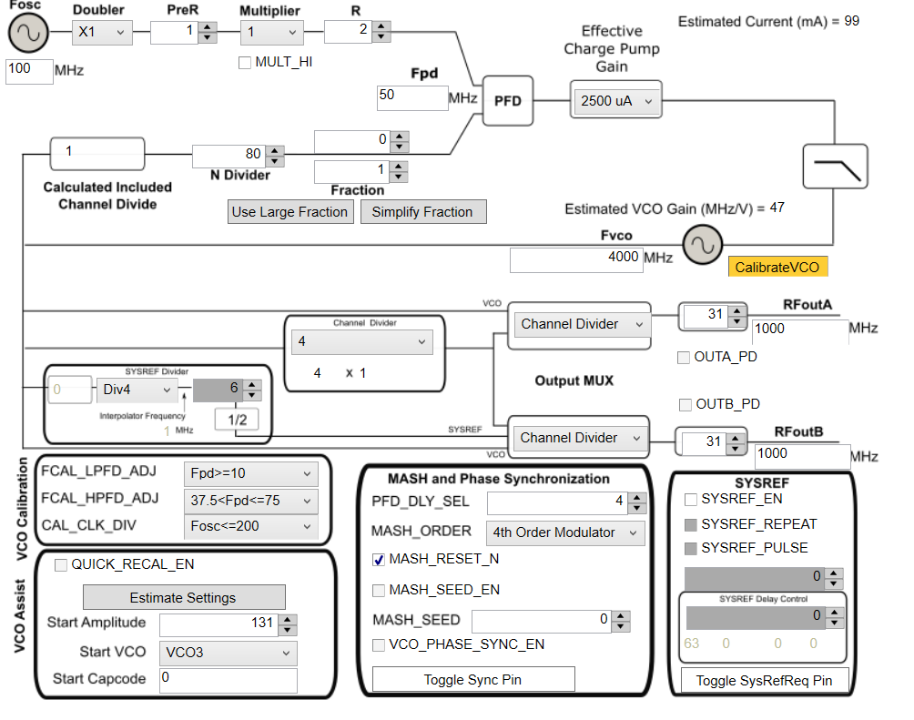

TICS Pro (v1.6.8.9, build datre 15.Nov-18) does not set the VCO core according to the datasheet. It also has different values for VCO_DACISET_STRT and VCO_CAPCTRL_STRT when I calculate according to the datasheet. What to trust? My issue is that with the TICS pro generated register values, the device works - with the datasheet values, the device does not work.
Tics pro python update code states:

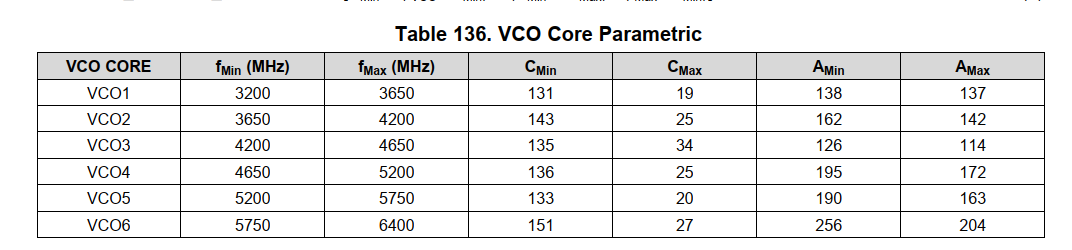

which is obviously not what is in table 136 of the DS.
while my code reads:
    @staticmethod
    def vco_core_lookup(fvco_in):
        Table 136 and 135 from datasheet
        fields = ('vco_core', 'fmin', 'fmax', 'cmin','cmax','amin', 'amax', 'kvcomin', 'kvcomax')
        data = [
                        (1,  3200,  3650, 131, 19, 138, 137, 32, 47),
                        (2,  3650,  4200, 143, 25, 162, 142, 35, 54),
                        (3,  4200,  4650, 135, 34, 126, 114, 47, 64),
                        (4,  4650,  5200, 136, 25, 195, 172, 50, 73),
                        (5,  5200,  5750, 133, 20, 190, 163, 61, 82),
                        (6,  5750,  6400, 151, 27, 256, 204, 57, 79)
        dicts = [dict(zip(fields, d)) for d in data]
        c = []
        for i in range(0, len(data)):
            if fvco_in >= data[i][1] and fvco_in <= data[i][2]:
                c = dicts[i]
        if len(c) < 1:
            print("LMX2572  Error: invalid VCO selection")
            return False
        kvco = c['kvcomin']+(c['kvcomax']-c['kvcomin'])*(fvco_in-c['fmin'])/(c['fmax']-c['fmin'])
        capctl_start = round(c['cmin']-(fvco_in-c['fmin'])*(c['cmin']-c['cmax'])/(c['fmax']-c['fmin']))
        daciset_start = round(c['amin']-(fvco_in-c['fmin'])*(c['amin']-c['amax'])/(c['fmax']-c['fmin']))
        return {'vcotable': c, 'VCO_SEL': c['vco_core'], 'VCO_CAPCTRL_STRT': capctl_start, 'VCO_DACISET_STRT': daciset_start, 'kvco': kvco}
can you advise? I do not understand why TICS pro registers work and DS values not - all other registers are identical.

  • Jonas,
    Thank you for posting this! You are absolutely correct. You can see from the TICSPro code, the intention was to follow the datasheet table, but the code is off by 1 core. Below is the new code that will go out in the next TICSPro release for both the LMX2572 and LMX2572LP.
