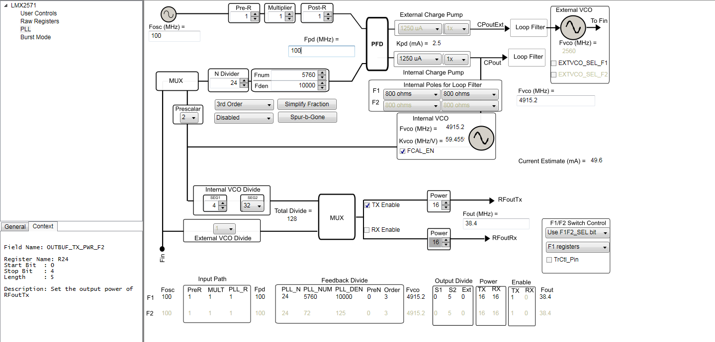

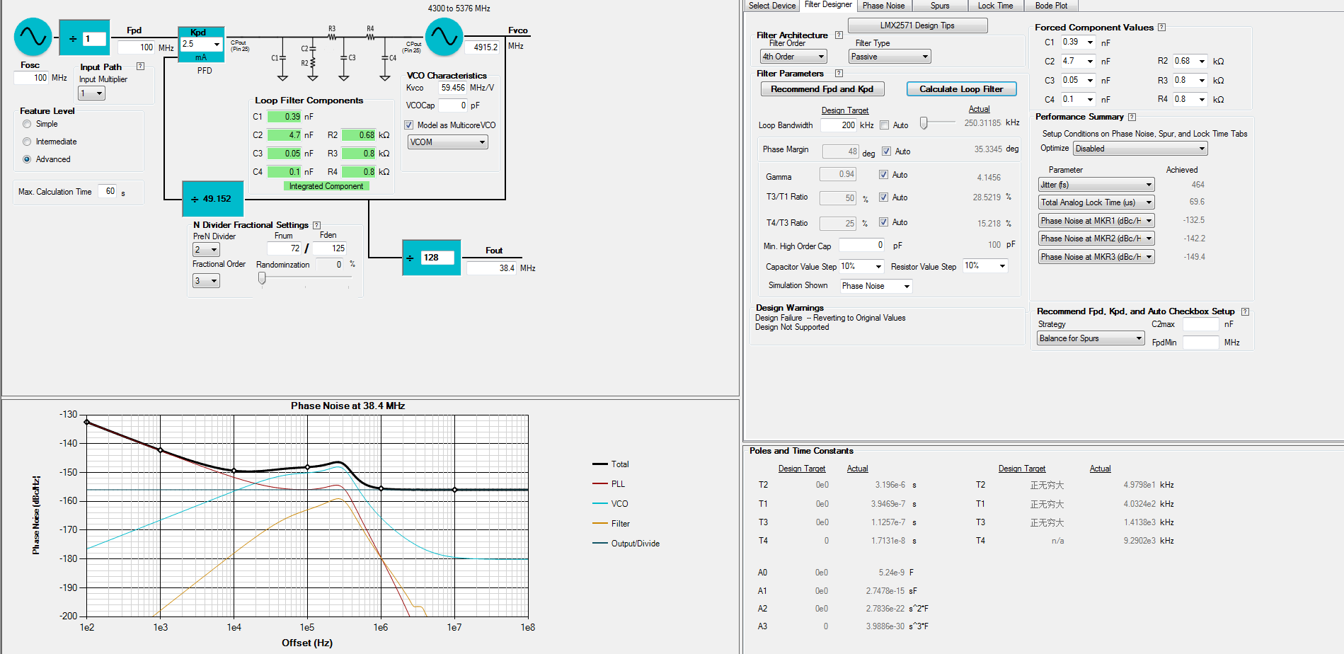

The output of 38.4M chip can not be locked into 40M or 38M can be locked, below is the , thank you.
Hi Jeff,
Please see if you can get lock status using attached setting: working_config.zip
