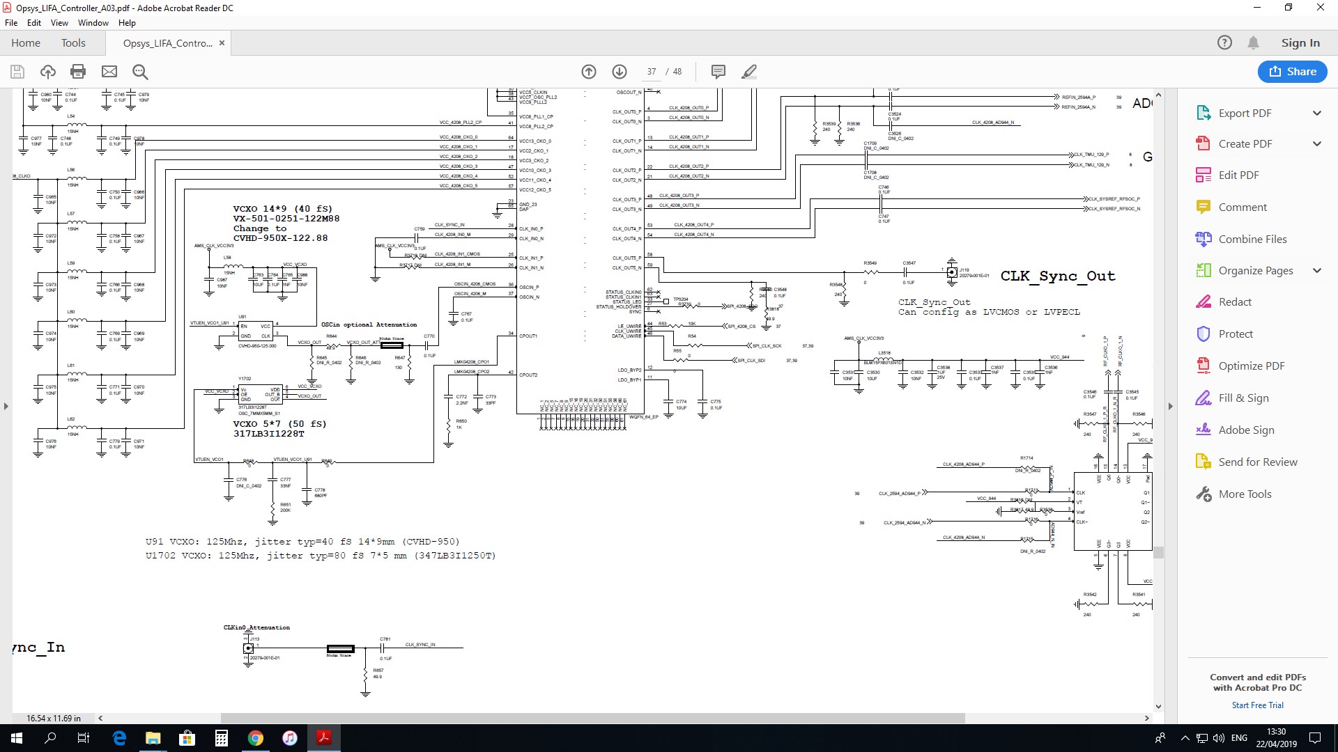

    At our design we got two boards (each with LMK) which work in un-synchronize mode. At one point the first card become master and the second to slave (where the LMX should be sync to CLK_in0, which is output of the first LMK, please see attach scheme). The clk_in0 is signal ended clk with 0.1uF cap to clk_ino_N and 50ohm termination and 0.1uF serial cap to clk_in0_p. Attach the clk input image
    The input define as bipolar
    As it look when we move to slave mode and change the initial config (as seen in the first post) to clk_ino:
    80140603
    2302806D
    The slave LMX do not lock with clk_in_0 (even that there is good clock at this input).
    Only after few time that we added capacitance element to this enter  (Scope prob) the LMX lock in with this input
    It there way or register to push the LMX to lock to the input clk
  • Hi Oded,
    You are connecting a LVPECL output to CLKin0 of another LMK device.
    Then, you should add a termination load at CLKin0 as follows.
    In addition, make sure the first LMK device is still locked when you are using the second LMK device.
