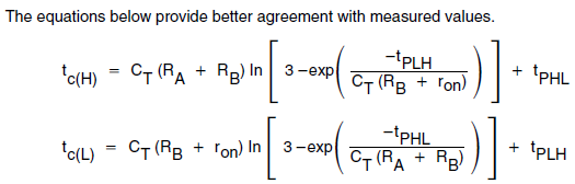

    You are missing propagation delay because the simple formula doesn't include that. 2MHz is close to the maximum frequency which is just a typical value of 3 MHz which is almost entirely propagation delay.  For 2 MHz try starting at 1k ohms and 370pF.  May need to be lower capacitor value if using at 5V.  Under 5V supply, might not get 2MHz at all.
    Here is a more accurate astable formulais below.  for 50% circuit RA + RB becomes RC + Ron(high) and RB + ron becomes RC + ron(low)
    Unfortunately tPLH and tPHL are not data sheet specs. Also ron(high) > ron(low)
