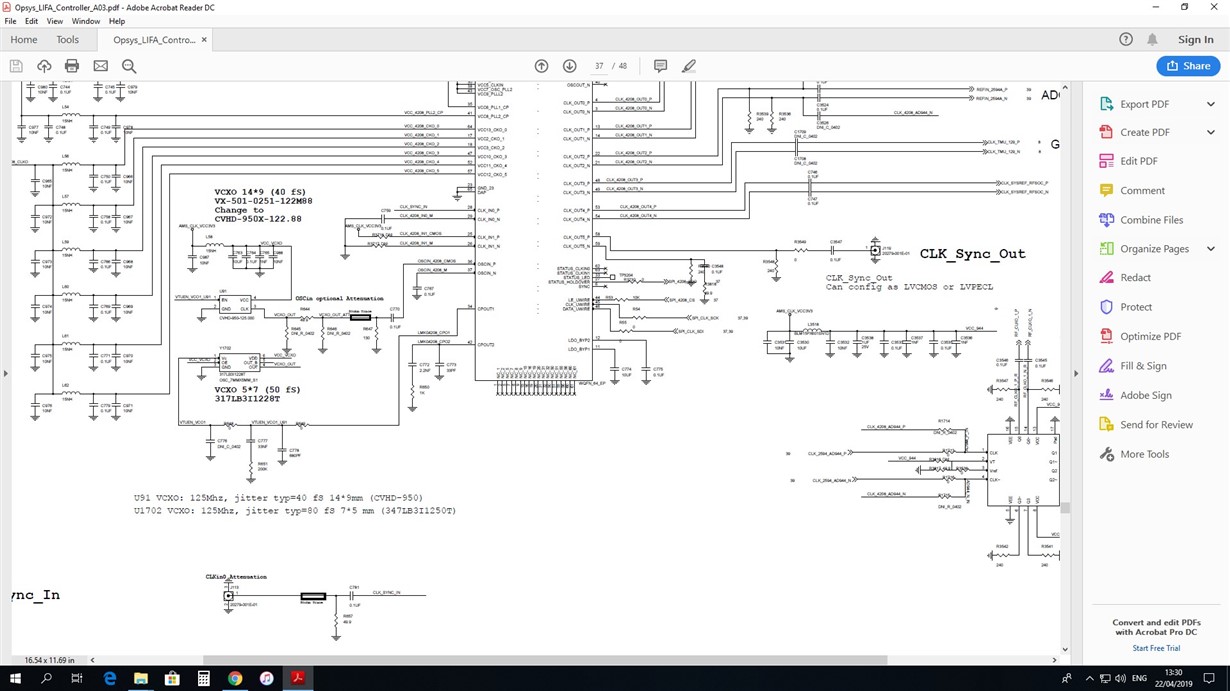

At our design we use LMK04208 to drive Xillinx FPGA in similear design as LMK04208 eval with external VCXO . We are using two similar cards when the first card is master which run as stand along mode with the below config file, and second card as slave where the master 125Mhz sync clock drive the slave clk_in_0 input.
We got 4 running card which each of them can act as slave (where it lock to the master 125Mhz clock) but one of the 4 cards fail to push (as master) the other 3 cards!!!
When looking with 20Ghz scoop on the LMK04208 output we almost dont see any differences
Do you got any idea what can cause this issue?
How can we inspect the jitter output of  LMK04208??

  • Hello Oded,
    Sorry for the delay...
    Oded Globerman said:
    So the master act is free run card, and the slave should lock to the output of the master and sync the clock
    To confirm.  So the board has CLKin0 as an input to PLL1, PLL1 does jitter cleaning with a VCXO, and PLL2 is used to generate your outputs.
    * When you say free run for master mode, you mean there is no clock applied to CLKin0?  This means the user case is more like single loop PLL2 and that PLL1 will rail.  This could be the reason why you are getting device to fail locking to board #4.
    I notice you have three different VCXOs listed. Which one are you using?  Are you using the same one on all boards?
      - VX-501-0251-122M88
      - CVHD-950-125.000
      - 317LB3I1228T
    It is possible that when the master rails, it rails to a frequency higher or lower than the other VCXOs can tune....  Then the slave will not be able to lock.  VCXOs have a relatively narrow locking range.
      * Try providing a 125 MHz clock from a signal generator to the master to see if that helps.
      * Alternatively, you could put the device into holdover mode with the Vtune forced to Vcc / 2.  You could achieve this by programming R15 as 0x8010802F.

    OG-When connecting 20ghz scope we got the same figure in master #1(that slave do not lock with)   and master #2 (image in may 30). We indeed look on this as issue #1 and We even try to replace the VCXO between Card #1 and Card #2, Card #1 still didnt lock slave card (maybe we should return on this test?, maybe we had some confusion in this test??)
    Do you got any other test idea that could help us understand better the issue?
    Oded
  • You would not be able to measure the frequency to the accuracy you need with the scope.  For CVHD-950 the frequency pulling APR min is +/- 20 ppm.  So if for example you had a +/- 50 ppm signal as reference, the VCXO may not be able to tune to the extremes of the +.- 50 ppm to lock.
    Can you use a frequency counter to measure the OUT5 frequency of all 4 boards in free run/master mode?
    I suggest providing a frequency accurate signal to CLKin0 for master or programming R15 as 0x8010802F to enable holdover and force the Vtune to Vcc/2 to keep frequency of master as accurate as possible by open loop.

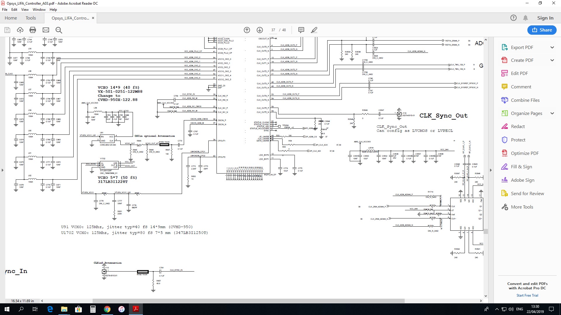

  • Dear Timothy,
    Thanks to your support we found the root of the problem. Indeed when connecting freq counter we found that working master is -50 to -60ppm shift (124.9930mhz) while non locking master is about -70ppm (124.9919mhz) freq shift
    We looked on the VCPOUT1 and found it around 0V. So the main problem is that PLL 1 is not loop the VCXO and pushing it the the lower edge! (With high speed scope we were blind to find this).
    So , does it mean our config file have some error?
    The original LMK config  was design to work with  122.88Mhz VCXO, We have replace and adjust it to work with 125mhz vcxo.
    Have we missed some thing in the config that cause PLL1 not to function. Attach again our config file?

  • Hello Oded,
    Change R15 to 0x8010802F in the master.  This will force holdover (FORCED_HOLDVER = 1) and therefore cause PLL1 to force a Vtune of Vcc/2 (MAN_DAC=512, and EN_MAN_DAC=1) volts on the VCXO.  This should raise the voltage and therefore the frequency of the VCXO to closer to 0 ppm.  If not sufficient, please try increasing MAN_DAC to a higher value.  You should be able to measure the impact of changing MAN_DAC by seeing Vtune1 of master change and therefore output frequency of master change.  Then, as slave attempts to lock, you should see a valid VCXO voltage on the slave instead of 0 V.
    I don't recommend the same configuration for master and slave.  Master should not free-run PLL1, it should force holdover.
    73,
    Timothy
