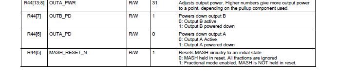

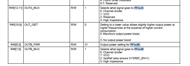

LMX2594: Only 1 Single Ended Output use of RFoutAP
Part Number: LMX2594
If i only want to use a single output (with single ended configuration) for example only from RFoutAP, what should i do with all other outputs ?
can i leave them open? didn't find any note regarding this question in the documents, did i missed something?
Tnx,
