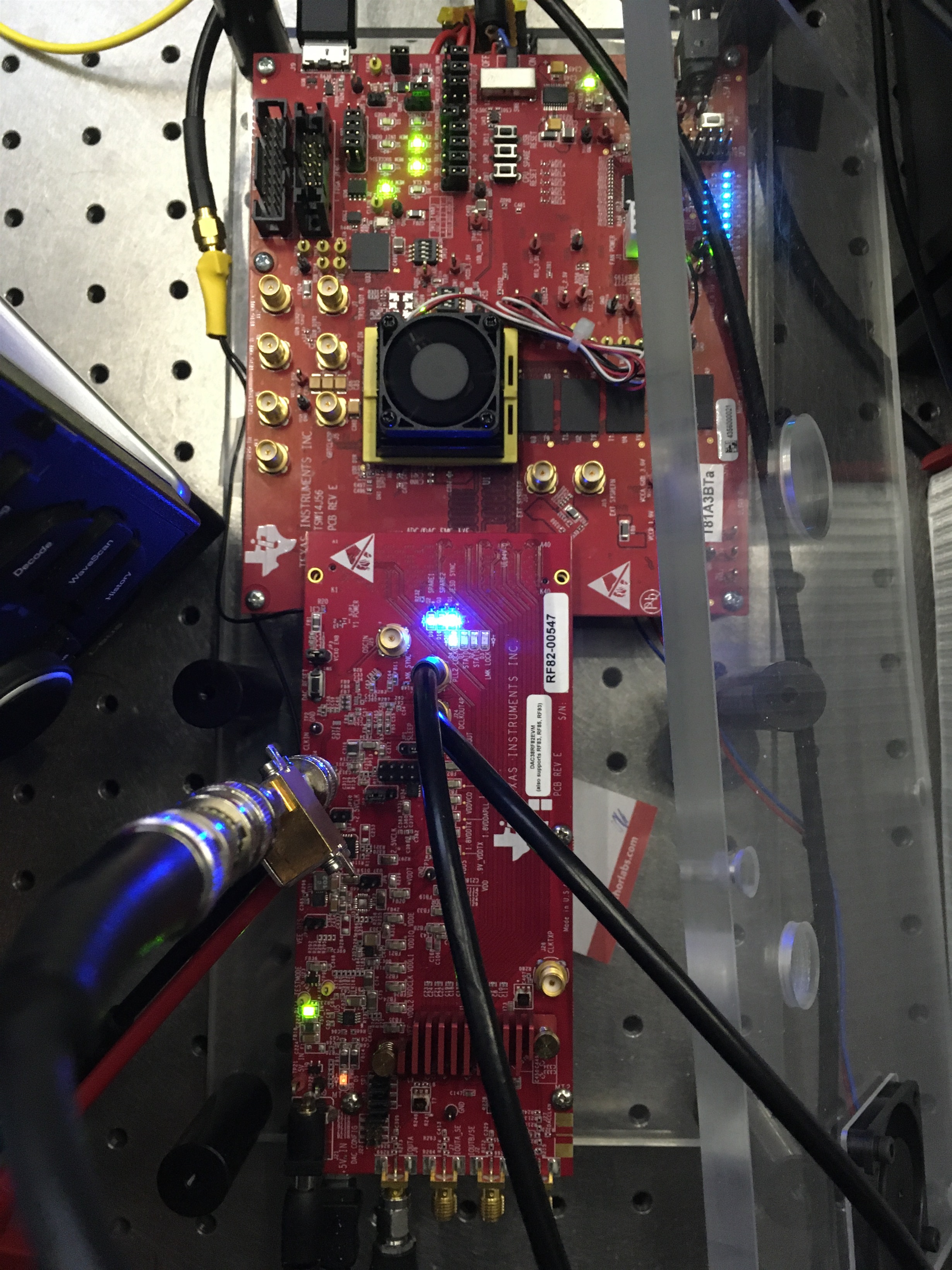

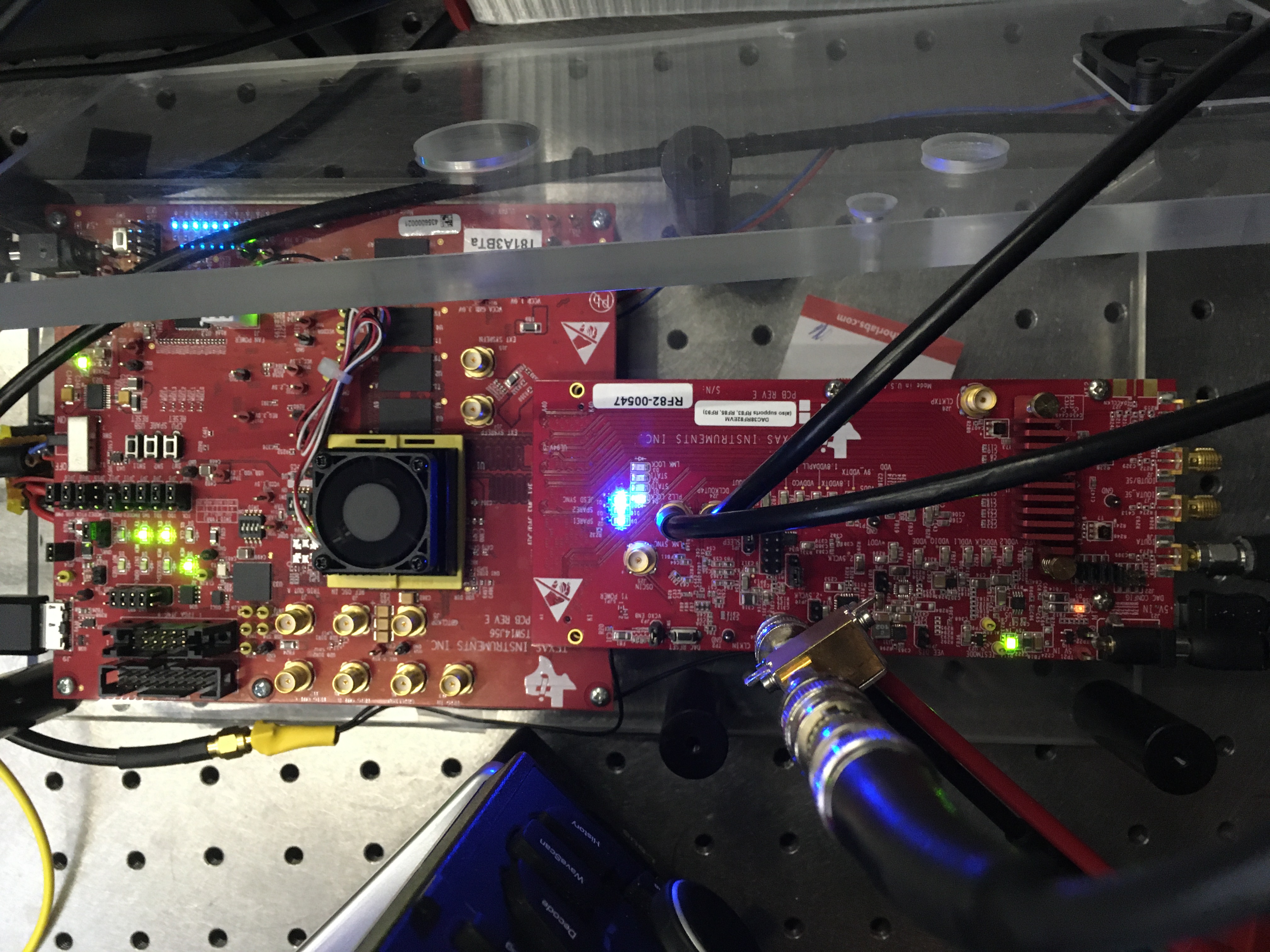

I am using a DAC38RF82EVM in combination with a TSW14J56EVM to run an optical experiment in which I want to synchronize the output data stream (8.84736Gsps) out of my dac (set according the configuration given below), to an external clock source given by the trigger of my pulsed laser which is running at 80.028MHz:

According to the parameters that i am setting  I get PLL1 LD and PLL2 LD turning green (the LD switches off when I unplug the laser clock off SMA J4). Therefore, I assume both PLL are locked and all clocks are in phase. Especially the dac sampling clock at 8.84736Gsps is in phase with my laser clock.

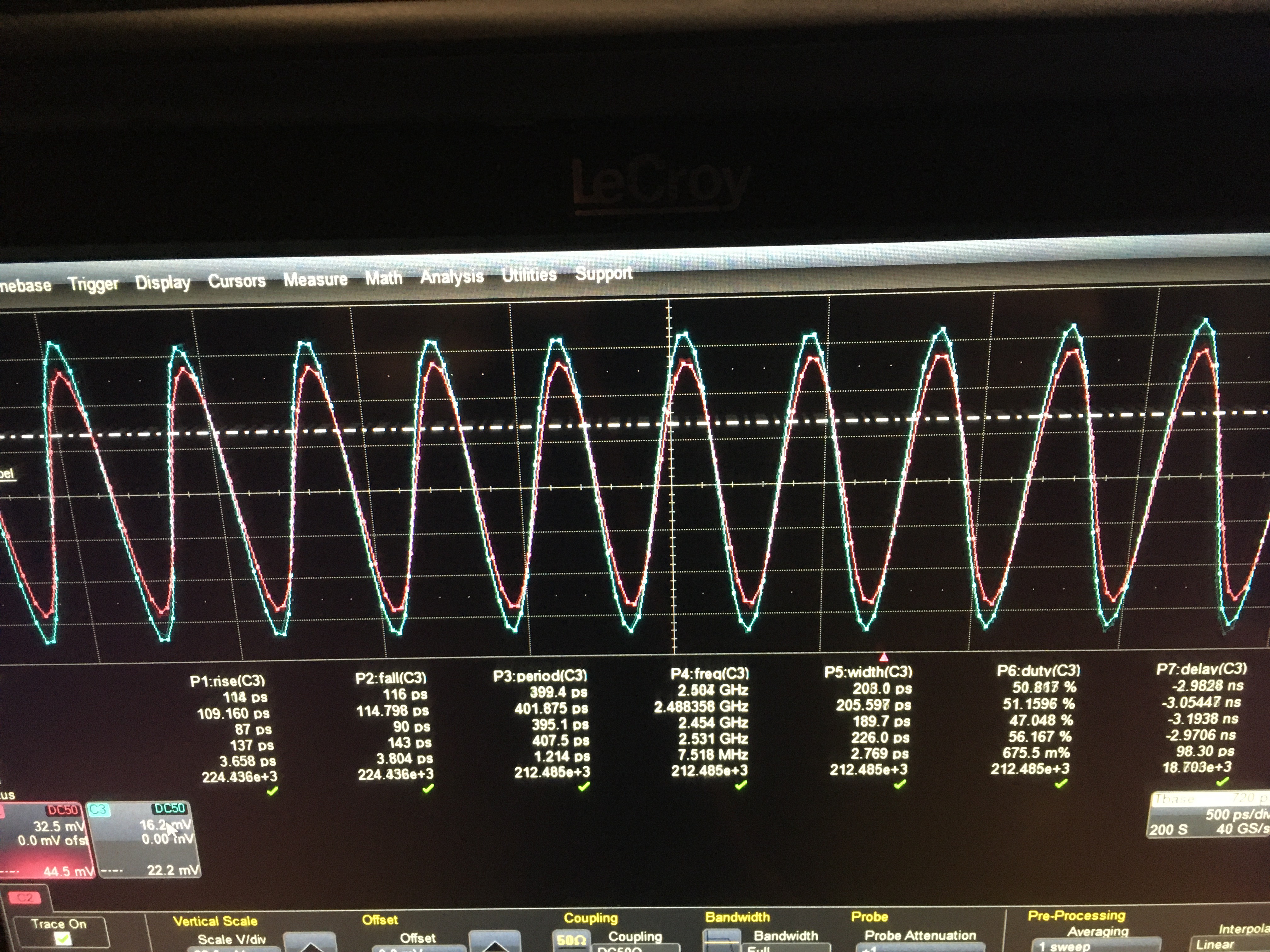

At this stage i generate a waveform which i send to a fast scope together with the laser clock. I would expect that, if locking is working correctly, the two pulses travel together but when i trigger on laser clock i see the generated waveform fluctuating back and forth.

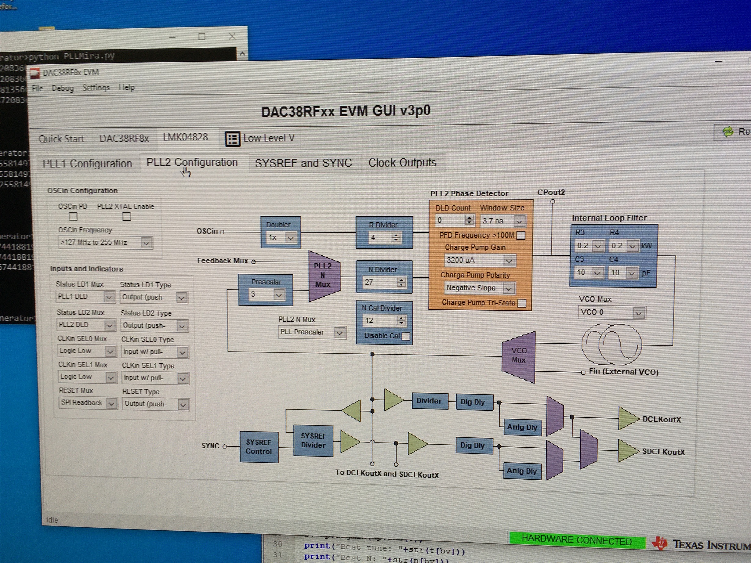

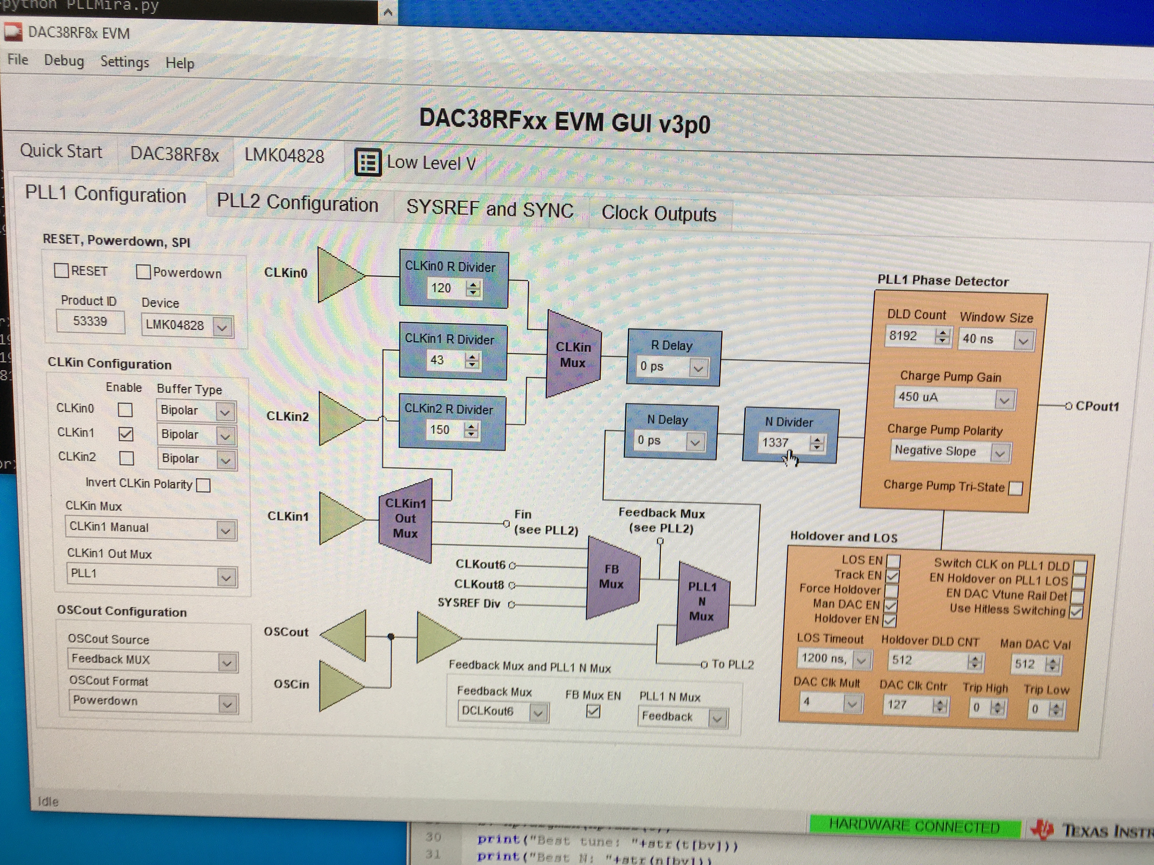

    Unfortunately, what i cannot do is to set PLL1 N-divider to 7680 (the max value allowed on the GUI is 4095). Is it a software problem or the N-divider can't be set so high for this product? for such  a reason i tried the numbers who closely match 2488.32 and 80.0823, namely N-divider = 1337 and R-divider = 43 even though 80.0283*1337/43 = 2488.32179302 which is not the exact value. You can check the pictures attached.
    What solution do you propose?

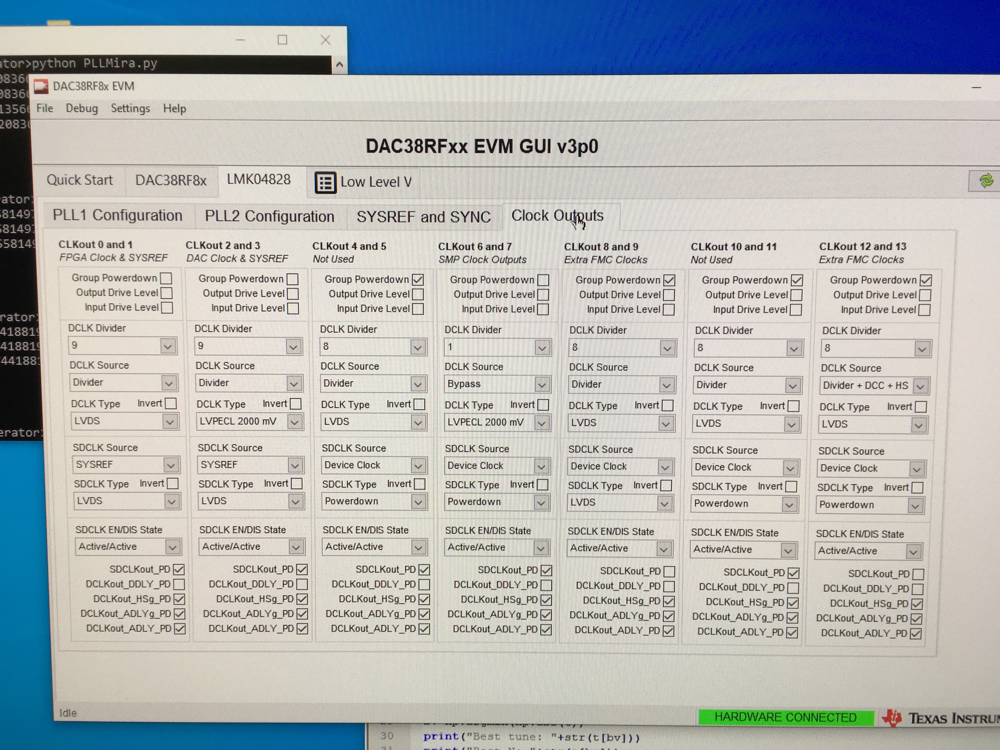

  • Hi Derek,
    i just made a new .cfg file e loaded it with the new settings. Now i can see the N-divider set to 7680. Nevertheless I cannot still see the pll1 green LED lighting up. I am wondering whether N-divider=7680 is actually set or the GUI just shows it. Can you please check if this .cfg is correct? lock9gsps.cfg
    Moreover i enabled clockout4(DCKL type = LVDS) with same settings as clockout6 and i see phase alignment between this and and LMK sync (namely, SMAj24 and SMAj8) which I expect to be correct.
    It seems just that the feedback clock at 2488.32Mhz can't lock to my laser clock source. Shall I play with the PLL1 Phase detector settings, R-delay or N-delay for phase adjustment?

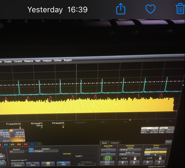

    Unfortunately i do not see any improvements even though I still see the DAC Locked led on, the PLL1 and PLL2 LEDs turning on as well (but PLL1 led light is rather dim). For such a reason I have been playing with holdover settings since the LMK cannot find the locking conditions all the time. Anyhow, In order to check if locking was working at least partially, I generated one single pulse with the DAC to investigate the time histogram correlations between my laser clock to SMAj4 (pink trace) and the pulse generated with the DAC(blue trace) that you can see in the graph below.
    As you can see the histogram is completely flat meaning that the two traces are not correlated at all and one signal comes at random times compared to the other one.
    i wonder what is still wrong. May you please provide me with a good config file and give me an explanation for my mistakes?

  • "... the PLL1 and PLL2 LEDs turning on as well (but PLL1 led light is rather dim)"
    It is possible that PLL1 can't lock well.
    "Unfortunately, what i cannot do is to set PLL1 N-divider to 7680 (the max value allowed on the GUI is 4095). Is it a software problem or the N-divider can't be set so high for this product? for such  a reason i tried the numbers who closely match 2488.32 and 80.0823, namely N-divider = 1337 and R-divider = 43 even though 80.0283*1337/43 = 2488.32179302 which is not the exact value"
    It is the reason. From reference, VCXO frequency, VCO frequency, we must match the exact frequency and integer divider. The EVM with 122.88 MHz is designed for wireless application. Maybe you can consider to change the VCXO for your application.
