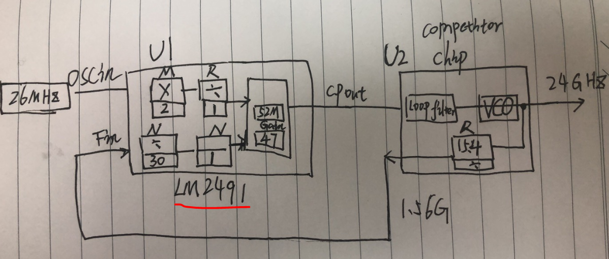

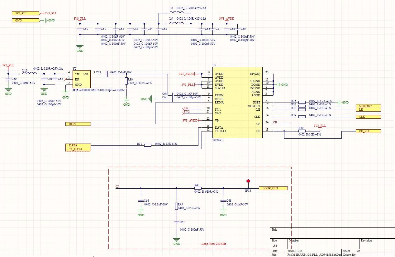

Hi Team,
Could you help me review the below LMX2491 SCH if it is ok?

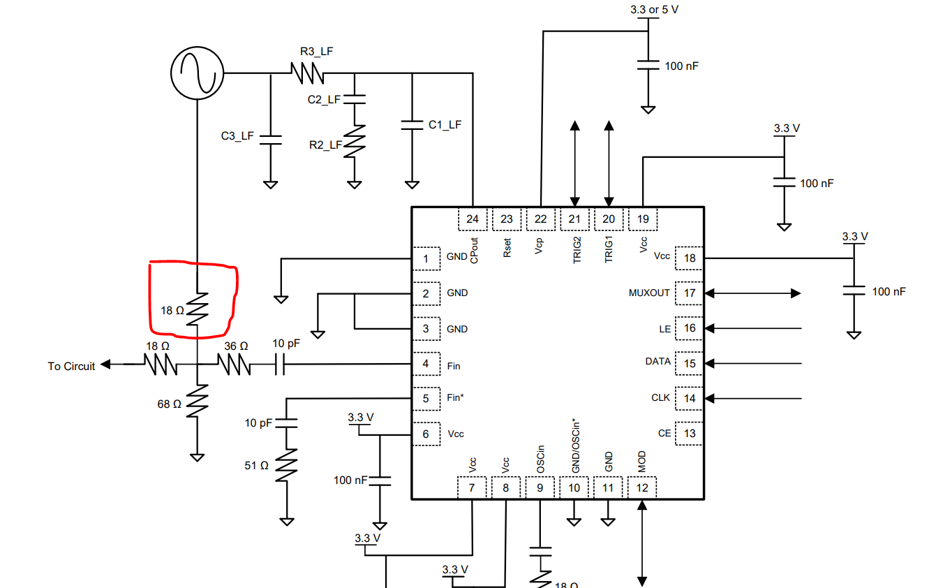

In the datasheet, I sawthere is a 68Ω pull down resistance in OSCin pin of LMX2491. What is effect of  68Ω resistance here? Why is  68Ω resistance rather than 50Ω resistance?
