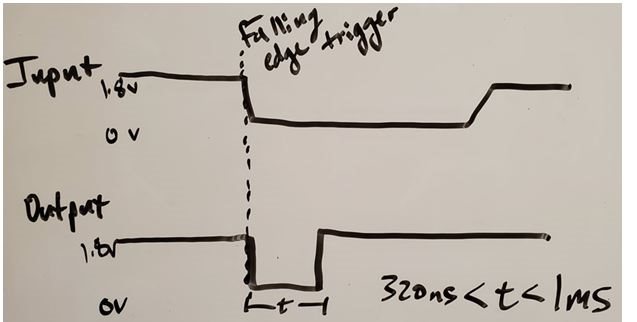

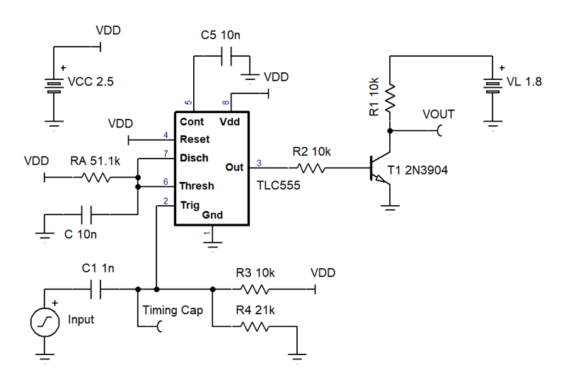

Looking to generate the a shorter output pulse based on the falling edge trigger .
Can I achieve this with the LM555 and an inverter gate ? how do I control the timing on the LM555.? Appreciate the guidance.
