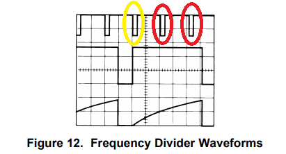

On monostable operation,
During output is High, additional trigger is ignored.  In other words, Red Trigger pulses are ignored.  Is it correct?  Please let me know.

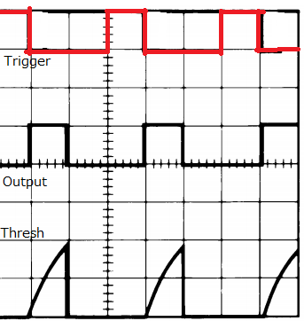

On the other hands, when trigger pulse is longer than output pulse, the following waveform is correct operation, because Trigger is only falling pulse timing.   Is it correct?  Please let me know.
Thanks and best regards,
