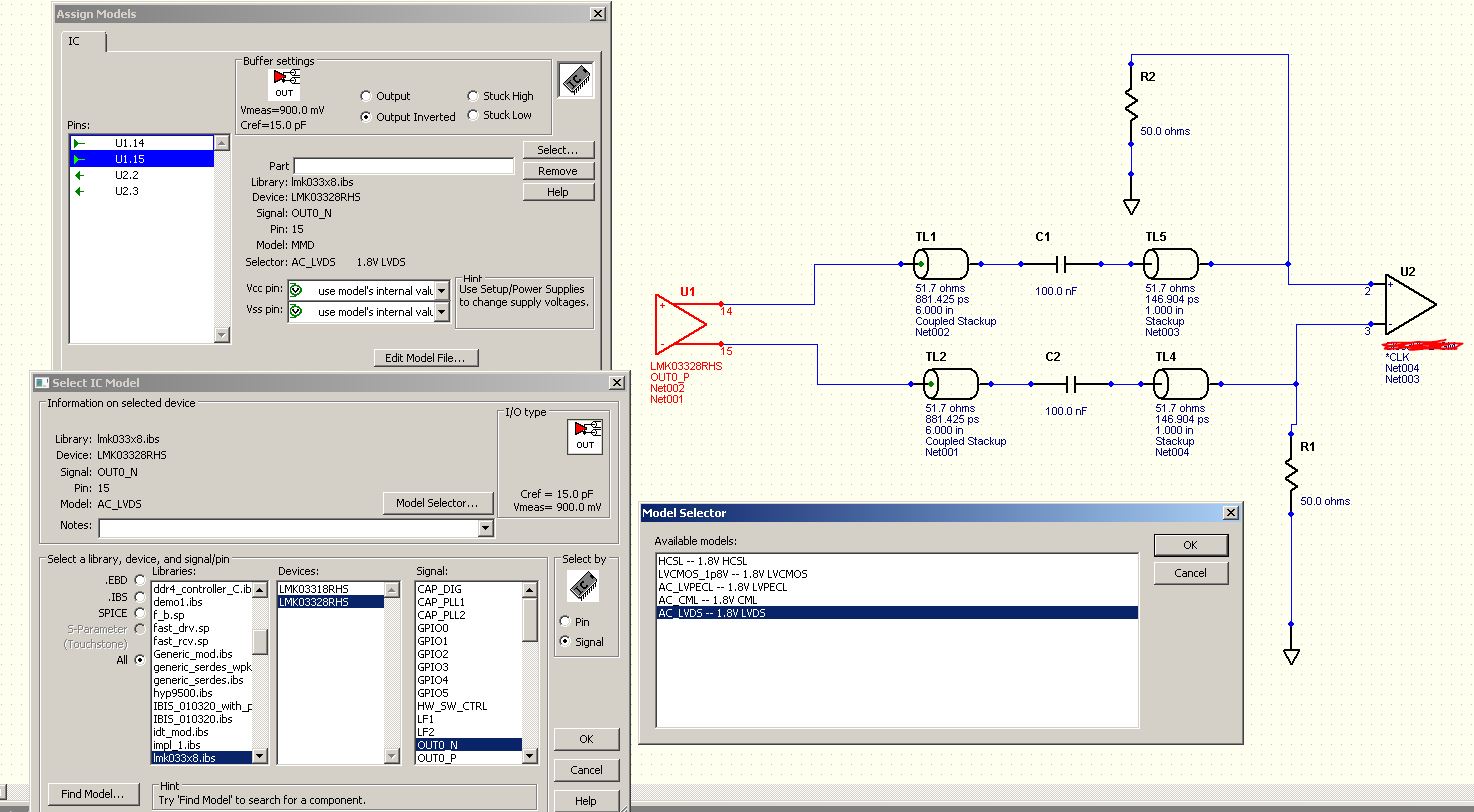

Hello
I am using the LMK03328 IBIS FILE downloaded from your site (lmk033x8.ibs, IBIS_ver=4.1, File_Rev=1.3,  Data -07-25-2017)

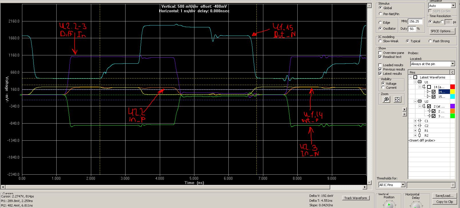

Seems to me as if the POS output pins (OUTx_P)  in LVDS mode , LMK03328RHS, are generating a faulty signal
I found out same problematic signal both in Pre (two LMK03328RHS, one is connected to the other) and Post Layout simulations
Can you ask please one of your IBIS experts to take a look at this file and verify the functionality of the LVDS OUT POS pin ??
