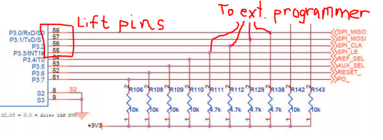

    At this point, I'm not sure what else to try. The Windows 10 driver compatibility issues we're facing took us very much by surprise, and it's unlikely that we'll be able to fix the driver install process for these GUIs - the team that made this and other CDC device GUIs is no longer part of TI, and we're not sure what they did with the source code. We aren't experts in the driver software either, and the USB communication devices are now reaching EOL. We're currently working on creating some kind of workaround instructions to allow programming these devices through an external programmer. Very likely this will be a "legacy device programmer" tool implemented in TICS Pro (TICSPRO-SW) that accepts the text register file generated by the CDC GUIs as an input, and communicates over a discrete USB2ANY programmer which will need to be manually connected to the communication lines. But it will not be ready for a while, definitely not until after the holidays are over.
    Right now, I think your best bet is to use some kind of external SPI programmer like an Aardvark, save the CDC GUI register file, and load the registers through the external programmer. You will need to lift the pins on the microcontroller SPI lines, attach wires to the SPI interface, and hook up the wires to an external programmer as shown below:
  • Hi Derek.
    I really appreciate your support, However I don't have any equipment to continue with your solution.
    Thanks anyways. .
