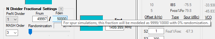

When the customer used in the decimal division mode (fout = 1499.999MHz) on the LMX2594EVM, spurious at offset 1kHz, which was not visible in the simulation software "PLLatinum Sim", is visible at a high level.

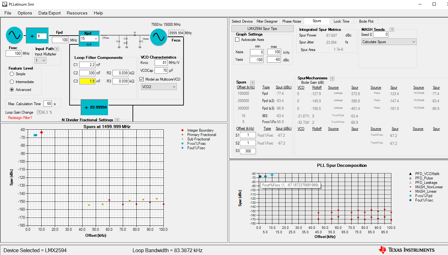

    I can see the 1kHz spurs from PLL Sim 1.5.6.0, it is shown at the bottom in the right column. 1kHz spurs is expected as this is a fractional spurs and crosstalk spurs. If you can scarify phase noise, you can change PLL_DEN to 5000001. Doing so will avoid fractional spurs, leaving crosstalk spurs behind. Hopefully this will reduce the overall spurs level.

    • The spurious level seen on the screen of "PLL Spur Decomposition" at the bottom right of the simulation screen is as low as -60dBc, but the spurious level actually confirmed with a spectrum analyzer was about 30dB higher than that. Is this discrepancy expected between the simulation and the actual machine results?
    • They would like to know the reason why the actual spurious level does not decrease even if MASH_ORDER is changed.
    • Which should they refer to? The spur screen on the bottom left or bottom right? Since it says "Decomposition", they understand that the components of the lower left spurious are displayed in the lower right, but why is the offset 1kHz spurious not displayed in the lower left screen?

  • Hi Fukui-san,
    Spurs frequencies are predictable but spurs level cannot be simulated accurately. This is because for the same spurs frequency, there exist multiple spurs sources. If the phases of these spurs sources are similar, then the spurs level is going to be big. On the contrary, if their phases are different, then the ultimate spurs level may be smaller. In addition, the spurs due to crosstalk are not able to be modeled. In summary, PLL Sim can help you find out the spurs frequencies at different configuration / loop filter characteristic. As for the spurs level, they are good for reference only.
    Modify MASH_ORDER may reduce spurs due to PLL, but it is not able to deal with crosstalk spurs. So, depending on the actual spurs mechanism, very often that using a different MASH_ORDER cannot help reducing the spurs level, but it may help reducing the number of spurs.
    I will let the tool owner know the problem of displaying different spurs in the plots and fix it in next revision release.

    Right, with different MASH configuration, we can predict the number of known spurs due to PLL.
    I think the plot on the left is a simplified version, otherwise there is no point showing two identical plots.

    • Customers speculate that the spurs component that appears every 1kHz is the fout% fosc component. Are these component the crosstalk spurs that you mentioned earlier in the conversation?

    As for the 1kHz spurs, with DEN = 50000 and third order MASH, I can predict fractional spurs and crosstalk spurs appear at the same frequency offset: 1kHz, 2kHz and 6kHz.
    The sources of the 1kHz spurs are PLL; crosstalk between RFout and fpd; crosstalk between RFout and the reference clock. So it is not surprise that the spurs level will be different between EVMs. I am sure you will see different spurs level if you are using different reference clock source.
  • Hi Fukui-san,
    I checked with the tool developer, the reason that 1kHz spur was missing on the left plot is because of the "memory size" limitation of the tool.
    If you mouse-over the Fden block, you can see the tool tips. So the simulation was actually done with a fraction of 9999/10000. As a result, there is no 1kHz spurs.
    On the right plot, it was purely a calculation and we were able to revert the 1kHz spurs.

    In response to the previous question, "What is the difference between left and right graph?", the answer was  "The plot on the right is a pure calculation result, and the 1kHz spurious is displayed normally."
    Given the above, should I refer to the screen on the right for the frequency components that are originally predicted to be spurious? What about the offset component spurs that appear on the left and not on the right?
    For example, Fvco% Fpd should be seen as a spurious at offset: 6kHz in the settings parameters of the file I sent earlier, but it does not appear on the screen on the right.
    (* Although you can see it on the screen on the left, if it is the color of the marker, the component is Fout% Fosc, and I think that this should appear 1kHz away originally)
    Ryotaro Fukui
  • Hi Fukui-san,
    Right, the right plot did not capture 6kHz spurs. I checked this with the developer, it appears that the calculation is correct but due to round-off error, the graphic displayed it at 5kHz instead of 6kHz. We will try to fix this in next revision. Thank you for pointing this out to us.
