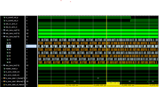

    Plus, here's another question I faced in simulation, I connected adc_lane_rx directly to dac_lane_tx to see if the loop is right. But I found that the rx_lane_data I received is different from tx_lane_data I sent. For all the 8 rx_lane_data it all repeat the same data from tx_lane 6 like this:
    I'm so confused and I checked for both rx and tx LMFS=8411 and HD=1, and tx_lane 0 &1 transmit sinei, tx_lane 2&3 transmit sineq, lane 4 &5 are the same as 0 &1, lane 6 & 7 are the same as 2 & 3. I checked dac_lane_tx and found that all 8 lane transmit the same data after K28.5:
    What cause this happen for the correct tx_lane_data but partically correct dac_lane_tx? Why 8 lane of dac_lane_tx repeat only one lane of tx_lane_data? I thought each lane of output should transmit the corresponding lane of input. And do you have any official simulation file for the ip?

    The other issue you are seeing is probably a Vivado simulation problem. Please check the jesd link params vh file and update the *LANE_MAP parameters to {3’d7, 3’d6, 3’d5….etc}
    The simulator is overriding all lane map values to 0, so all Rx lanes are showing data received on lane 0. This problem is not seen with synthesis or other simulators like Cadence or Mentor.
