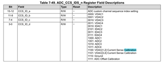

Register configuration:
ADC_CCS_IDS_00x70)= 0xDCFE
ADC_CCS_IDS_10x71)= 0x3210
ADC_CCS_IDS_20x73)= 0x7654
ADC_CCS_IDS_30x73)= 0xBA98
ADC_CCS_CFG0x42)= 0x010F
ADC_GEN_CFG(0x40) - CMODEbit2)= 1Auto-mode
The customer wants the best accuracy performance but they are not sure if the calibration operation is needed for every conversion, D/S stats “To optimize the ADC performance, run a single conversion of the calibration channels at start-up”, could you help elaborate on it and give the correct calibration process step by step?

    ADC initiation configuration: Perform the register configuration in the following order.
    Stage#5
    ADC_CCS_IDS_n register is at the default value and ADC is configurated to Auto-mode, ADC_CCS_CFG Register is set to 0x040F. Then the customer found that the ADC sample value is not correct and only change the ADC_CCS_CFG Register to 0x010F the ADC sample value is recover to the expected value.

    From going over your register configuration, your CCS_IDS_1 is F (as the value of ADC_CCS_IDS_0 is 0xDCFE), which is the ADC offset calibration code. This means that (from my understanding) when ADC_CCS_CFG = 0x010F, your sample value is correct because the ADC offset calibration was run in the first step of your conversion sequence, whereas when ADC_CCS_CFG = 0x040F, the ADC offset calibration code F is skipped.
    I have ordered an EVM to my desk in Dallas so I can verify this on the board; in the meantime, since it appears you are not using the IDAC channels for now in your application, can you write the value 0xDCFE to register 0x72 in ADC Config (instead of 0x7654)? Once this is done, I believe the 0x040F setting should work correctly

  • Hey Shawn, hope you are doing well. As an update, I got to run ADC conversions on the 60804EVM today at the BU lab, testing all 4 channels. I found that in my case, ADC offset calibration needs to be run once at startup, as if you start conversions without running that calibration all returned ADC values are approximately 10mV lower. However, if ADC offset calibration is run and the ADC_CCS_CFG register is subsequently changed to 0x040F, the conversion return the correct values and ADC offset calibration doesn't seem to be required for each conversion after the first one in order to observe consistent values.
    Can you verify whether you are able to obtain a correct value from the ADC for a conversion after just the ADC offset calibration has run? To test this, set ADC_CCS_CFG to 0x0101 first (which will not perform any conversion, but will perform the offset calibration) and then set ADC_CCS_CFG to 0x040F to run conversions. In my case, the above test seems to yield correct values, so I would like to double check. If you could also send me the voltages you are providing to each ADC channel, I can run the same voltages on my input channels and cross verify the results. Also note that you should use the original register configuration (i.e 0xDCFE is in register 0x70, and 0x7654 is in register 0x72
