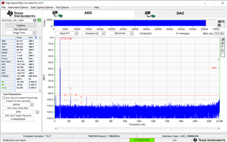

  • Hi David,
    The balun on our EVM has a minimum frequency of 500 kHz, so I was only able to test this with an input of 750 kHz using our ADC3222EVM. Chopper Disabled (left) and Chopper Enabled (right) - NSD is listed in the capture specs.
    Regards, Amy
  • Thanks.
    Maybe you can zoom in to the relevant region, 0-1MHz?
    So that the corner frequency would be visible.
    would you expect the 1/f noise to be affected by the properties of input signal (amplitude , frequency...)?
    David.
  • Hi David,
    Yes 1/f noise can be affected by the input signal, especially if it is not properly filtered. Power supplies can also be a source of 1/f noise.
    I zoomed in on the plots to better see the impact at lower frequencies:
