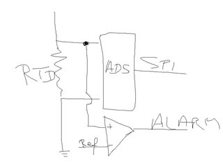

I would like to measure my RTD sensor, and this chip seems more thn capable to do so. One thing i am not sure, but I need is some safety feature, an Alert signal or safety shutdown basically what I would need is an SPI independet signal if my temperature goes whatever Kelvin I set. To rephrase my question, I measure my RTD and if it goes above 200C degree I need to shut the system down, independently from the SPI beacuse its not considered safety reliable way

    Unfortunately the ADS124S08 does not have this type of capability.  The ADC converts a voltage and not a temperature.  The ADC can be used as a ratiometric measurement where if the excitation (such as a current) that is used for both the RTD (a resistance) and the reference (also a resistance) the code value returned will represent the resistance of the RTD in proportion to the reference resistance.  Some method of conversion (LUT or polynomials) will be required by the host processor to convert the resistance to a temperature.  There is not a direct way to program the ADS124S08 to read or compare the measured value to a specific temperature.
    What I have seen for other customers do is to use either a comparator or another ADC that has comparator capability.  Which method used would depend on the required functional safety rating.  A comparator would be a fairly simple method to trigger at a designed voltage threshold.  The comparator input voltage would be across the same RTD sensor connected in parallel to the ADC and when the RTD voltage is greater than the threshold voltage an alert can be triggered.

    Thank you for your reply, that was exactly what I was thinking of. In both cases where would you put the ADC/Comparator?
    Like this?

  • Hi Zsolt,
    That is the basic concept.  How the RTD and comparator are actually implemented may be slightly different based on actual system design and excitation method for the RTD.  See A Basic Guide to RTD Measurements for different types of configurations and RTD  implementation.
