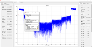

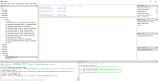

    However, I encountered a new problem when I tried to save data with an ADC. I tried to use the AFE.saveCaptureData() command, the program will report an error, I tried the command shown in the picture, but was unsuccessful. Can you give me a specific example of a save command?
    In addition, I also tried to EXPORT the csv file from the CGUI interface with export, but I could not find the exported csv file, can you tell me where it will be stored after export?
    Thanks again for your help!
    Jintao
  • Hi Zhu,
    The issue that you are facing with the function to save data is the path you are using. To use this correctly you should use double backslash in the entire path.
    Please try the following: AFE.saveCaptureData("D:\\Matlab\MatUserDoc\\test.csv")
     I would recommend to use the function to save the data as teh EXPORT from the CGUI seems to not be functioning correctly. I will check with our team on how to fix the Export or where the data is being saved.
