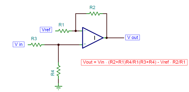

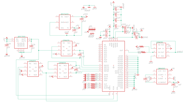

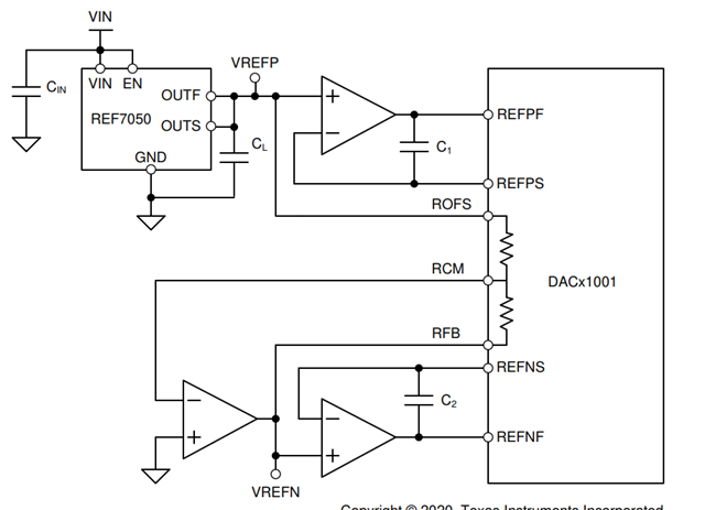

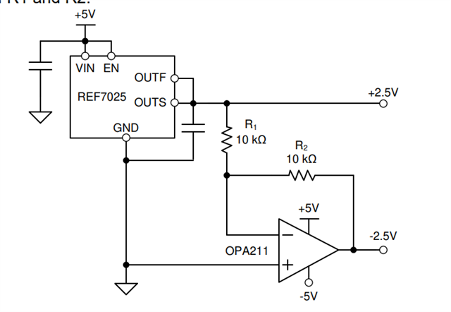

Following the reference circuit on the DAC11001B pdf Document I am working on a schematic to use the DAC11001B in a configuration Such that its output voltage goes from 0-5V maybe even slightly higher what is the best approach to get this output? The main voltage supply I currently have is a positive 5V with no negative Voltage supplies. I would like to Do this with the +5V source referenced to ground only if possible but i could use voltage converter chips to get the negative 5V if I have to. Is it as simple as making the reference voltage op amps go from ground for v- and 5v for v+ ?
