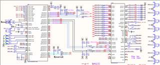

  • Hi Daniel,
    Can you please send us your schematic of the DAC and output frontend? Let us know where you are probing as well.
    Rob
  • Hi Bob,
    Below is my schematic about DAC38J82, and I connect A+ to scope directly.
    Best regards
    Daniel

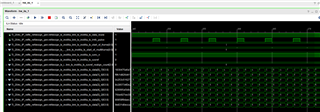

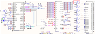

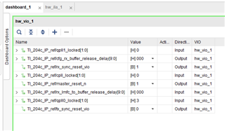

  • Hi Chase,
    Thank you for investigation.
    1. I have change RBD to 32, but it is still same result.
    2. "What is the reference clock into the TI JESD IP?" . I only have TX in TI JESD IP, the tx_sys_ref not used and tie 0 in example design.
    3. Also I have try continues SYSREF for DAC. Still not work.
    4. The qpll_locked is 2'b11, please see attached screenshot. I also attached my schematic and LMK04828 settings, please help see any issue.
    5. About muxing, do you mean the SERDES lane to JESD lane muxing? As my understanding, usually it will be One-to-one correspondence (SERDES lane0 to JESD lane0, SERDES lane1 to JESD lane1, etc.). Is it correct ?
    6. May I know the sequence about reset. Reset DAC JESD first or reset TI JESD204 first ?
    7. Would you please share your DAC38J82 settings?
    Daniel

  • Hi Daniel,
    If the pll is locking on FPGA side, the reference clock will be correct.
    When I say lane muxing I am referring to the muxing to correct for any mismatch between the FPGA output lane and the DAC input lane. I'm not familiar with the mapping on your hardware so for now it is ok. This won't prevent any output from showing - if incorrect it would just look badly.
    The sequence for bringup is:
    1. Configure LMK
    2. Assert DAC reset (should be hardware reset but I tested and can confirm software reset is ok (assert register 0x02 bit 0)
    3. Configure DAC
    4. Assert master reset
    5. Assert tx reset
    6. Deassert master reset
    7. Verify PLL locks
    8. Deassert tx reset (after deasserting tx reset, FPGA will start transmitting data over serdes, whether K28.5 symbols or data depending on SYNCb state)
    9. Toggle DAC JESD Reset
    10. Assert 2 SYSREF pulses to DAC (automatic if using continuous sysref)

    I notice the SYSREF input to the DAC says LVDS but you are terminating it as if it was LVPECL through 200Ω pulldowns and then AC coupling, all while the LMK output format for SDCLKOUT3 is set as LCPECL. For an AC coupled LVDS output of the LMK04828, there should be a light 560Ω differential termination before series AC caps. Can you try changing the output format for the SDCLKOUT3 output to LVPECL1600mV by changing register 0x10F to 0x56 instead of 0x76?
    Thanks, Chase

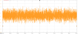

  • Hi Chase,
    I have try the  output format for the SDCLKOUT3 output to LVPECL1600mV, still not work.
    Also I have check the lane mapping from FPGA to DAC. My understand is if the mapping is wrong, the ILAs will mismatch for LaneID between JESD IP and DAC reg config, and the link cannot be established. Is it right?
    Attached is my waveform now, seems noise.
    I will check everything again.
    Thanks, Daniel
  • Daniel,
    If the Lane ID does not match then the DAC will give a link configuration error. You can try toggling the mem_no_lane_sync field (register 0x4F bit 5) which will ignore the link configuration errors.
    Thanks, Chase
