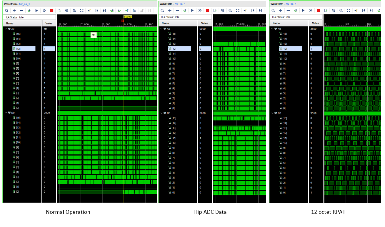

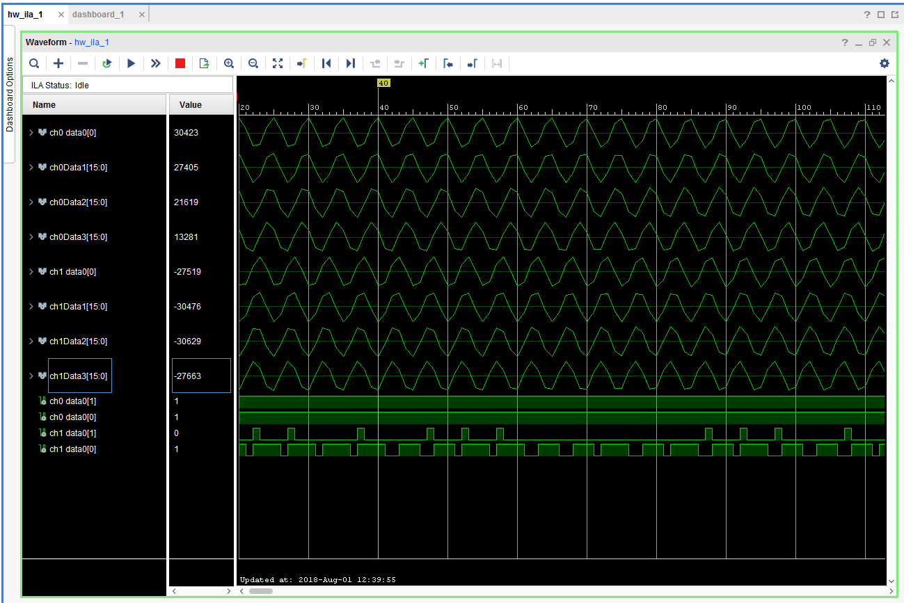

In the following setup we are seeing some stuck bits in position A0(1:0) and B0(1:0) in the received ADC data on the FPGA.
Sometimes bit 0 toggles in the data, sometimes it is stuck. But bit 1 is always stuck.
IF we "Flip ADC Data" then the position of the stuck bit changes to A0(14:15) and B0(14:15)
If we us the 12 octet RPAT JESD Test pattern there are no stuck bits.
(diagram below shows captures from 3 scenarios)

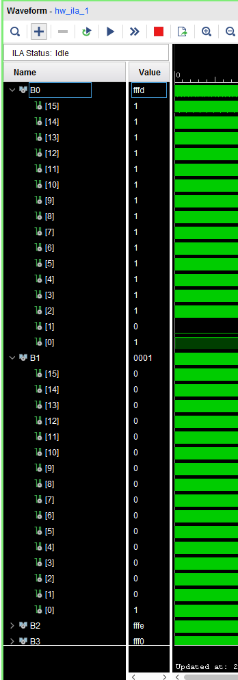

  • In the screen shots the only bit to not be toggling is A0(1) and B0(1), B0(0) will some times be static and some times toggle. Given this is noise all the other bits are just sign bits. And just to be clear by every forth sample that means every A0 sample. The Vivado ILA is running at 250MHz, for the full giga sample pattern will have A0,A1,A2 & A3 at 250 MHz. The same applies to the other channel.
    Richard

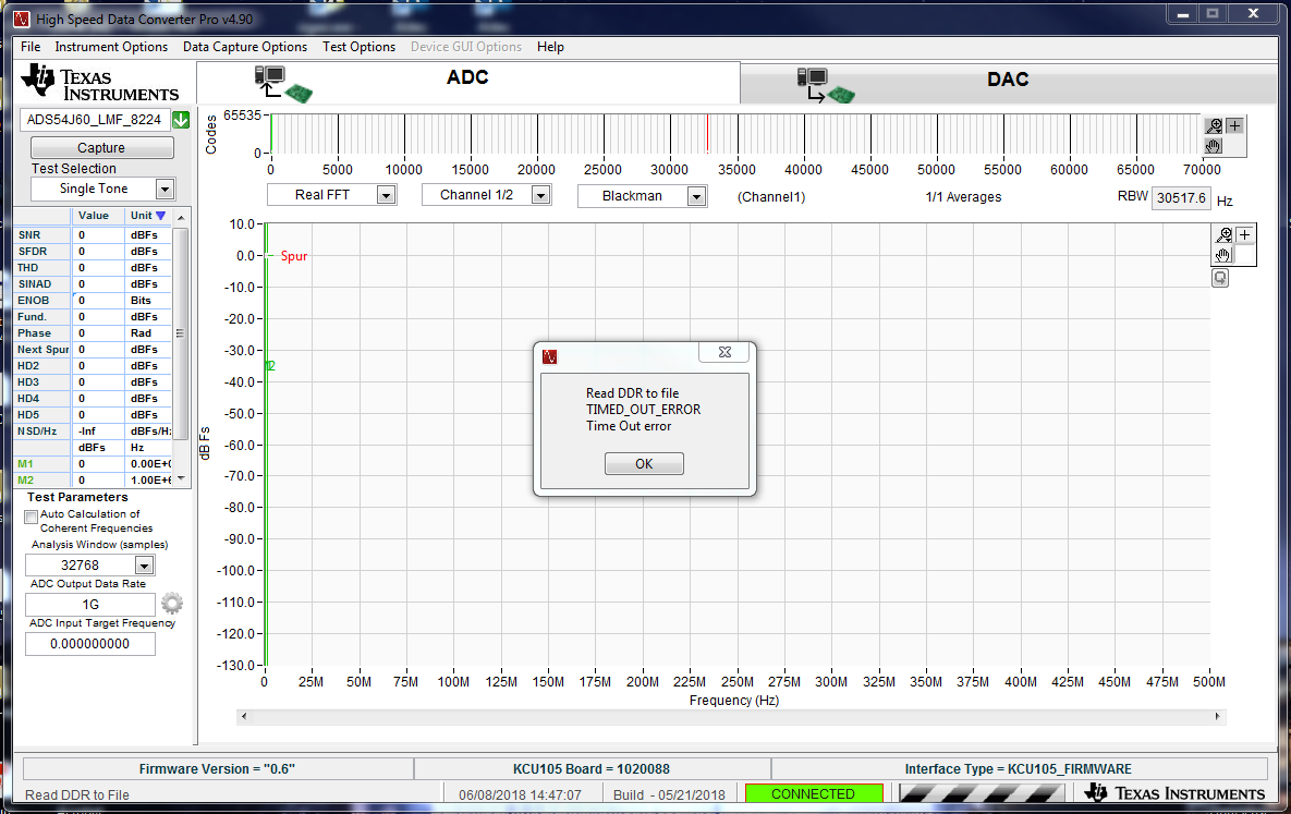

  • I have just tried to use the build that comes with the High Speed Data Converter Pro following the instructions in slau711. When required to change the FMC VADJ to 1.8V, when doing the Read FMC HPC is says the card is not present. Regardless of this I tried to continue setting up the LMK and ADC for a 1GHz reference although the instructions are not for the ADS54J60EVM so the menus in the guide don't match. I then try a data capture and get a timed out error.
    Is the reading the FMC an issue or not given we've got a different board from the guide. Are you able to provide a configuration file for the LMK and ADC that will definitely work for a 1GHz reference in distribution mode.
    The other thing I noticed in the instructions was about connecting the clock to two inputs, J5 and J7. I guess this is the equivalent of J4 and J6 on our board. Given we want to use the LMK in distribution mode is there a need to provide both clocks?
    Cheers
    Richard

  • Using those two scripts I can't get the HSDC Pro software to capture the data. That LMK script doesn't have clock 12 activated so I assume the JESD core in your design is setup to use a single clock. It'd be nice to get your HSDC Pro build working so are those scripts you pointed me at definitely designed to work with the bit file provided with that software? The first capture I tried I get an error message about the JESD core, all other captures then say DDR timeout.
    Also you never answered my question about being able to adjust the VADJ and not being able to read the FMC EEPROM section of the SLAU711 instructions.
    As we've said previously we see this stuck bit behavior on both ADCs that are on our own FPGA cards so it's unlikely to be the individual devices.

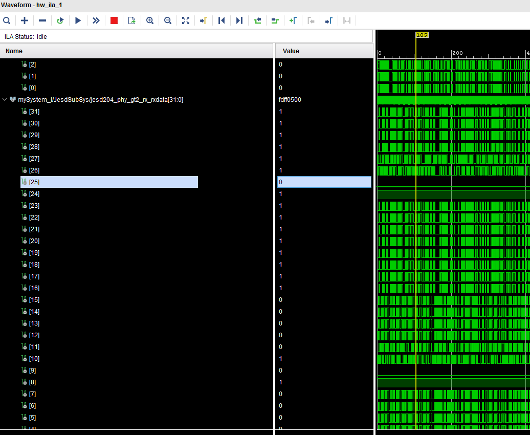

  • Adding more "chipscope" to the noddy design I shared with you I am able to see that the static bits are present in the data stream coming out of the phy section of the JESD core. I believe phy has nothing to do with sysref or sync but just undoes the 8b10b encoding so this really does suggest the static bit is in the transmitted data.
    We've also used the example design created with the JESD IP and also see the stuck bits.
    As I've said though given we see this on a range of hardware I don't believe it's a hardware fault (although I guess if you can send me some 1G sample data with an 8224 JESD scheme to show it's not a general problem) but probably the way we're driving or setting up the device.

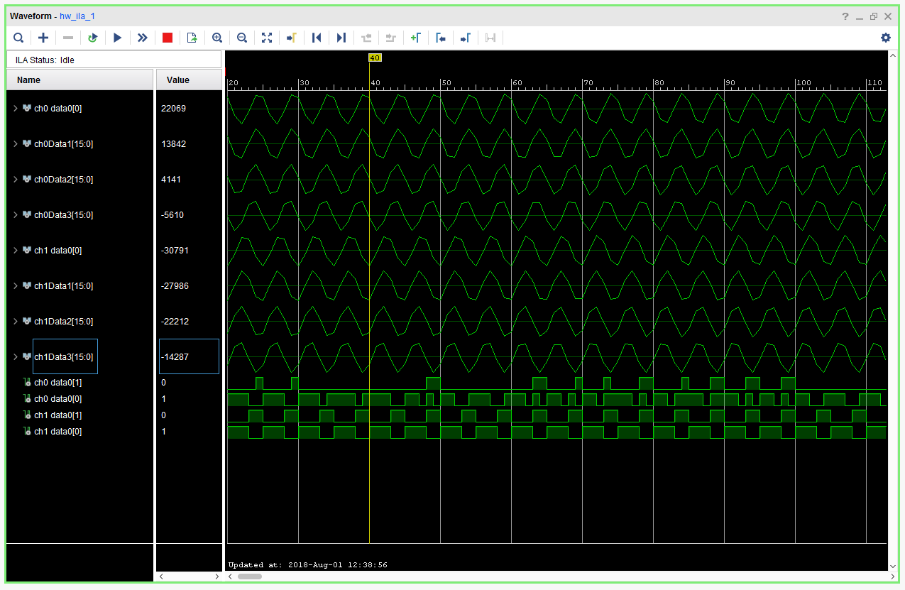

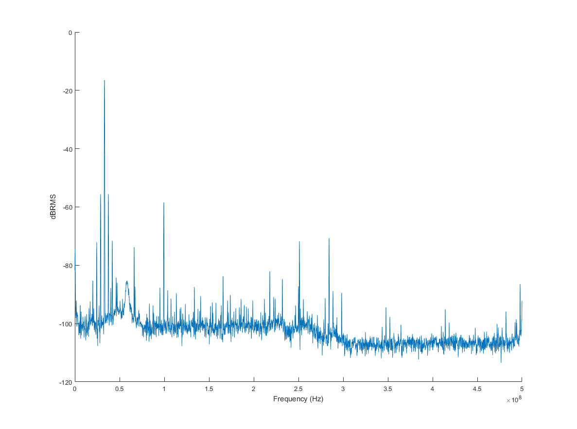

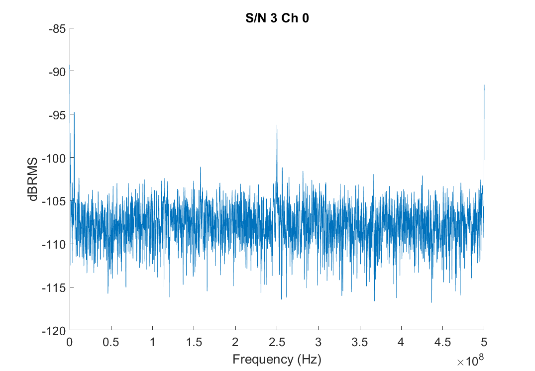

  • Just to reply to the comment about those bits being in the thermal noise. Bellow is the current ADC noise floor we get (this is done by capturing from our design in Vivado and importing into matlab as I am unable to get the HSDC Proc build to work). As you can see there is a distinct tone at 250MHz.

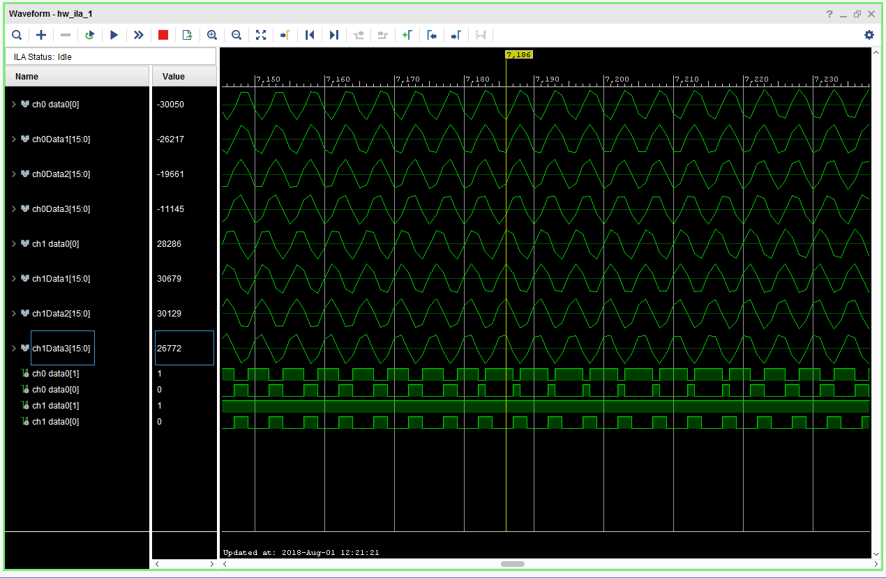

  • That was the change we tried but the resulting behavior is not consistent.
    On successive ILA captures
    - Sometimes both bits [1] and [0] of A0 and B0 toggle
    - Sometimes all of them are stuck
    - Sometimes 1 or 2 of them toggle and the others are stuck. There seems to be no pattern to it.
    The behaviour certainly has changed by writing to that address. Previously, bit [1] did not toggle at all. But it hasn't fixed the problem.
    Regards, Isabel

  • What time domain data do you want? Attached is a CSV file of the data without writing to that register.
    I have been under the impression that the stuck bits were causing the 250MHz tone, if in fact another issue is causing that then that is my priority. When used in our system we will have carriers at 210MHz and 310MHz so do not want extra tones around that area.

  • Here's a screen shot of the behavior after the register write when inputting a 2Vpp 50MHz signal. The offending bits from channels 0 and 1 have been replicated at the bottom. They are now toggling (although occasionally you can get a capture with them back to static) but the pattern suggests they aren't random, especially since on ch0 bit 1 is the inverse to bit 0.
  • Here's some more captures I'm not sure what makes it transition from one pattern to the others.
  • Even when I occasionally get a capture with what looks like random toggling the 250MHz tone is still there. Here I've got a 33MHz single which has some harmonics from the sig gen but images are also created either side of the 250. Have you got some data you've captured or your system that shows if the setup is correct we can get a better spectrum.

  • Your signal generator is obviously cleaner than ours. It would be nice to get the HSDC Pro working on our setup if you could tell me how to get passed that DDR timeout error. I see you had the capture window at 65536 so I guess it doesn't need to be reduced to 32768.
    I'm surprised not see anything at 250MHz as your own data sheets says there should be interleaving tones there but I guess you sig gen has raised the noise floor enough to cover it.
    Have you de-interleaved the capture to see if every 4th sample has stuck (or atleast odd) behavior in bits 0 and 1. If you're able to achieve that spectrum with the bits being weird then it means they're not important and it's another setup issue that's creating the 250MHz.
    Attached is the data the plots are from. I have an input signal at 1MHz, 33MHz and 50MHz. I didn't use our actual frequencies as the extra noise from our sig gen would end up masking the problem tones.

  • Still get this message

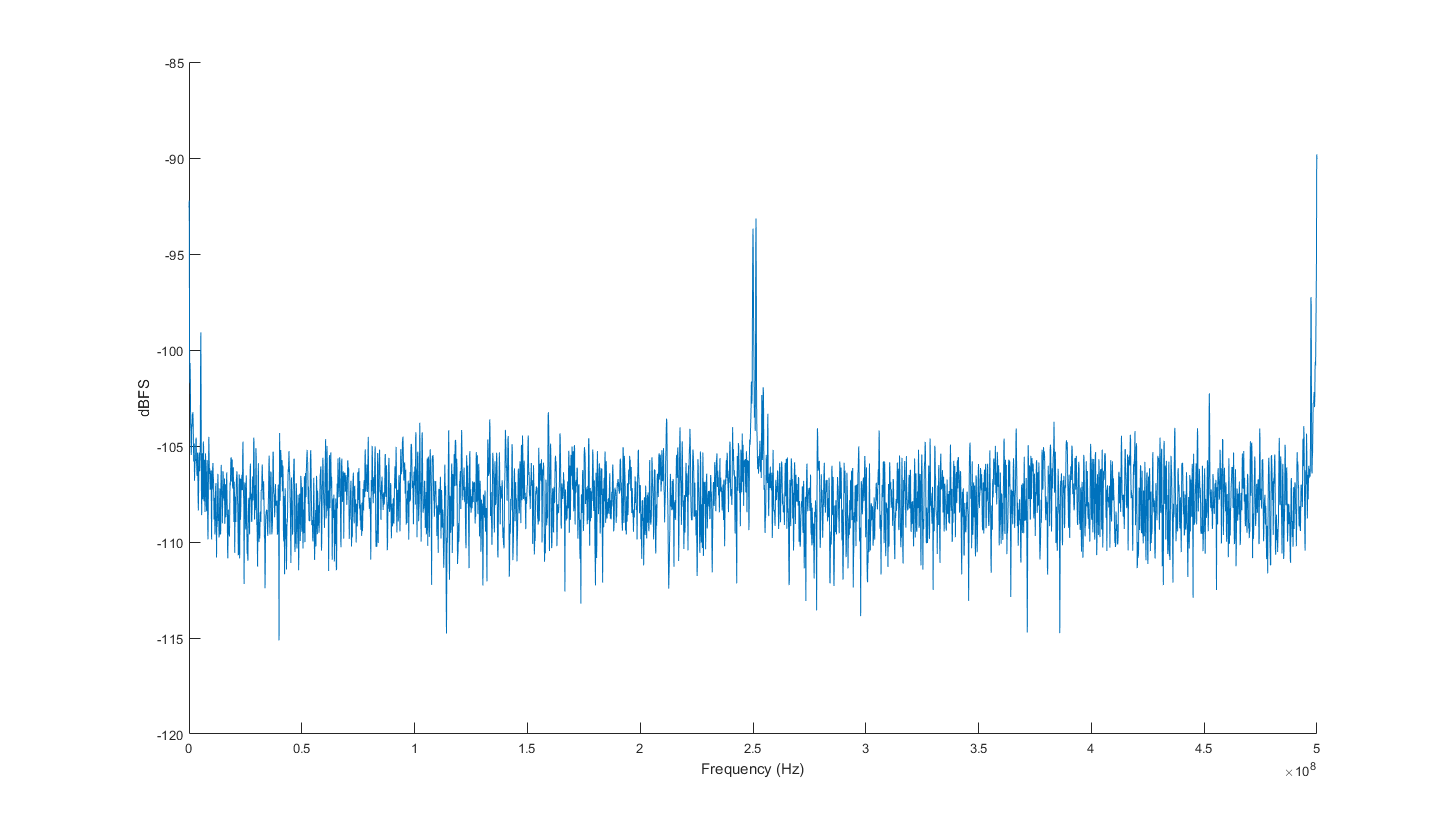

  • This is our raw ADC noise floor, no signal is being injected. The ADCs will be driven from the output of balanced optical detectors and our calculations suggest that the ADC will be the limiting factor even if we're getting the full 11.6 ENOB which is why we're checking the noisefloor is as expected.
    The 1GHz clock souse is an RFX OS364 part. It currently just free runs but in the full system will be trimmed to a GPS 1PPS. The circuitry mimics that of the eval board.
  • I should add this was without the extra register write. In our main system the clock distribution and ADCs are setup by a processor and we haven't updated it's source to set the extra register.
