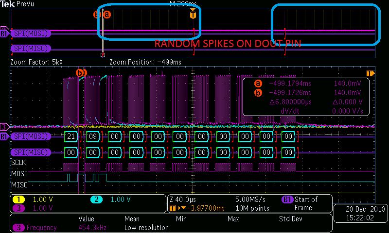

  • Dear Bob,
    We connect DIN and DOUT pin as you suggested. It was our writing mistake.
    Today we observed random spikes on DOUT pin also.
    Please find attached image of SPI communication waveform for Timing related information , Random spikes observation and Data Received
    from ADS114S06
    Thank You.
  • Hi Jehan,
    If you are tying CS low, then part of the problem is the command needs to timeout as you are not sending enough SCLKs for the command sent. Your command is to read registers starting at register 1, reading 10 registers (as the second byte is the number of registers to be read minus 1).
    Also, many of your digital lines go through resistors or connect to resistors as pullups or pulldowns. I would suggest making sure that all supplies are available at the device pins of the ADS114S06, and reset is pulled high. The device will not communicate if any supplies are missing or if the RESET pin is floating or held low.
    Another method for checking if the ADS114S06 is truly in an operating state is to pull the START/SYNC pin high and monitor DRDY. DRDY should be pulsing at the default data rate. If you do not see this, then the ADS114S06 is not powered or is in a reset condition.
    Bob B

  • Hi Jehan,
    I have no idea what might be causing the spikes on DOUT. One potential possibility is CS does not have a good connection to ground through the resistor and may actually be floating. Do you have any other devices connected to DOUT? Are there any traces adjacent to DOUT that might be causing a cross talk?
    Did you correct the mistake in your RREG command? You will have continuing issues with trying to read or write to the device if you have incomplete or incorrect commands sent. This might also be causing DOUT to glitch or spike depending on what is being decoded as the command.
    Bob B
  • Hi Bob,
    There is no any other device connected to DOUT pin. We already Check voltage at CS pin it is GND permanently.
    We already correct RREG Command, We got correct data too. But spikes of 62µsec is available at every 1.2msec duration. so please suggest us proper solution for this one.

  • Hi Jehan,
    I was making the assumption that the default settings are being used for the ADS114S06 (single conversion mode at 20sps). Have you attempted to write any of the configuration registers of the ADS114S06? The DOUT/DRDY pin is a dual function pin (see section 9.5.1.4 on page 60 of the datasheet.) The DOUT/DRDY pin will follow the DRDY pin end of conversion period. If the ADS114S06 is configured for Continuous conversions and 800sps you will see the DOUT/DRDY pin transition similar to the manner you have stated. You can verify by placing a scope probe on both DRDY and DOUT/DRDY and you should see the same update period.
    The reason for dual functionality is that in some cases a limited number of inputs to the micro are available and DOUT/DRDY can function as both DOUT and DRDY. A separate DRDY is useful if more than one device is connected to the SPI bus requiring DOUT/DRDY to be high impedance when CS is used. The DRDY is an always active output that can be monitored separately from the SPI communication.
    Bob B
  • Hi Bob,
    We checked waveform of DOUT/DRDY and DRDY pin. We observed random spikes available on both pin as mentioned above comments.
    Is there any disadvantages or it can make any problems for temperature measurement process?
    Currently we are trying to read ADC Data but we are getting zero value from ADC output.
    All configuration registers are set as per our requirement. All voltages on pin also matched with datasheet mentioned data.
    But still we are getting zero value from ADC output.
    Please suggest us a proper solution for this.
    Thank you.
  • Hi Jehan,
    As the 'spikes' you are seeing relate to end of conversion, this will not affect your measurement.
