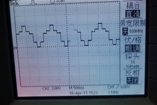

  • Hi,tony
    I'm working on a project about the driver of stepper motor.
    I use also the TLC7524, and i connected the circuit as what Rafael proposed, my Vdd is 5V,Vref 5V.
    But the maximum of the output is 4.4V, it can never arriver at 5V.
    I don't know why. and the wave is not correct.
    can you give me some suggestions?

  • from the photo,we begin from 0.
    i input the signal of a sine-wave,the first step is ok,the second ok,but the third one ,it should be much higher, we can see the difference between the 2nd and 3rd step is just 0.4V. Finally the 4th step,it should arrive at 5V.but it stops at 4.4V.
  • In this photo, i changed the number of steps from 4 steps to 16 steps.
    the wave became so confused.
  • Hi Ma,
    It could be that you are saturating your output amplifier. Does the output behave correctly and step up as you would expect until you reach ~4.4V? At 4.4V, the output remains clipped at 4.4V as you continue to increase the codes. What are your power rails that the amplifier is powered off of?
    -Tony

    When I didn't connect the amplifier, I could see the wave from 0-4.4V. If I augment the VDD to 7V or larger, the output become smaller than 4V. If I reduce VDD to 2V, the output become even much more smaller.
    For example ,i give the Vref 5V,VDD 5V.  At the output from 0-2.5, it seems perfect. But the wave from 2.5-4.4, it's not what i want. I expect that i can find the output ranges from 0-5V, but not 0-4.4.
    When I connect the amplifier with VDD 10V, at the output I can find a signal very very small at about 30 mV. It seems there's somthing strange at the source. I don't know where it  is.

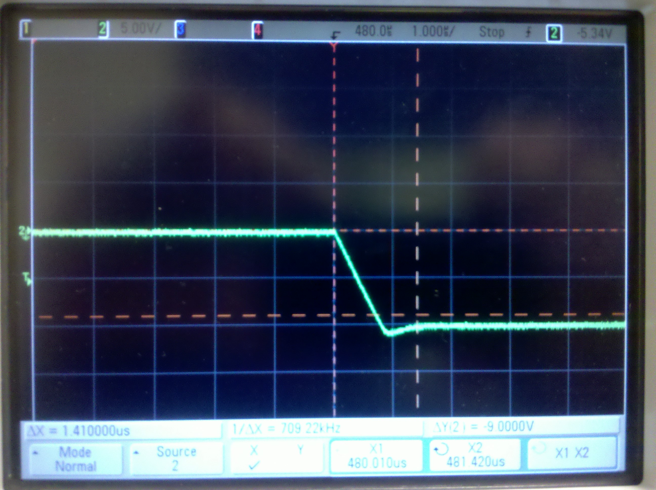

  • Hi Tony,
    Thanks a lot for your reply. I think I can understand you answer. We did the test setup again and got the reasonable test results.
    Now we have problem about the propagation delay and settle time test. The test setup is shown in the following picture. To do the test, all the DB pins are connected together to one functional generator, which is used to generate 1k Hz square wave. The low level is 0 V and the high level is 5 V. We used the oscilloscope to get the waveforms of the input and output. Here, we used 100 ohms resistor as the load at the output. But we could not get the full scare output voltage as I mentioned it to you before here and you suggested us to increase the load resistance. Then we used a 2K ohms resistor as the load and then we can get the full scare output voltage. Then we used the 2k ohms resistor to do the propagation delay and settle time tests.
    The definition of the propagation delay in the datasheet is from the digital input to 90% of the final analog output current. Instead of measuring the output current here, we used 90% of the final analog output voltage to get the delay time, which is from the input turned on to the 90% of the output voltage. The delay time we got here is about 8us which is much larger than what is said in the datasheet. If we used the definition of 50% to 50%, the 50% of the input is behind the 50% of the output voltage. I could not understand why this happened.
    We used the same setup to measure the settle time, which is about 1.2us, much larger than the datasheet.

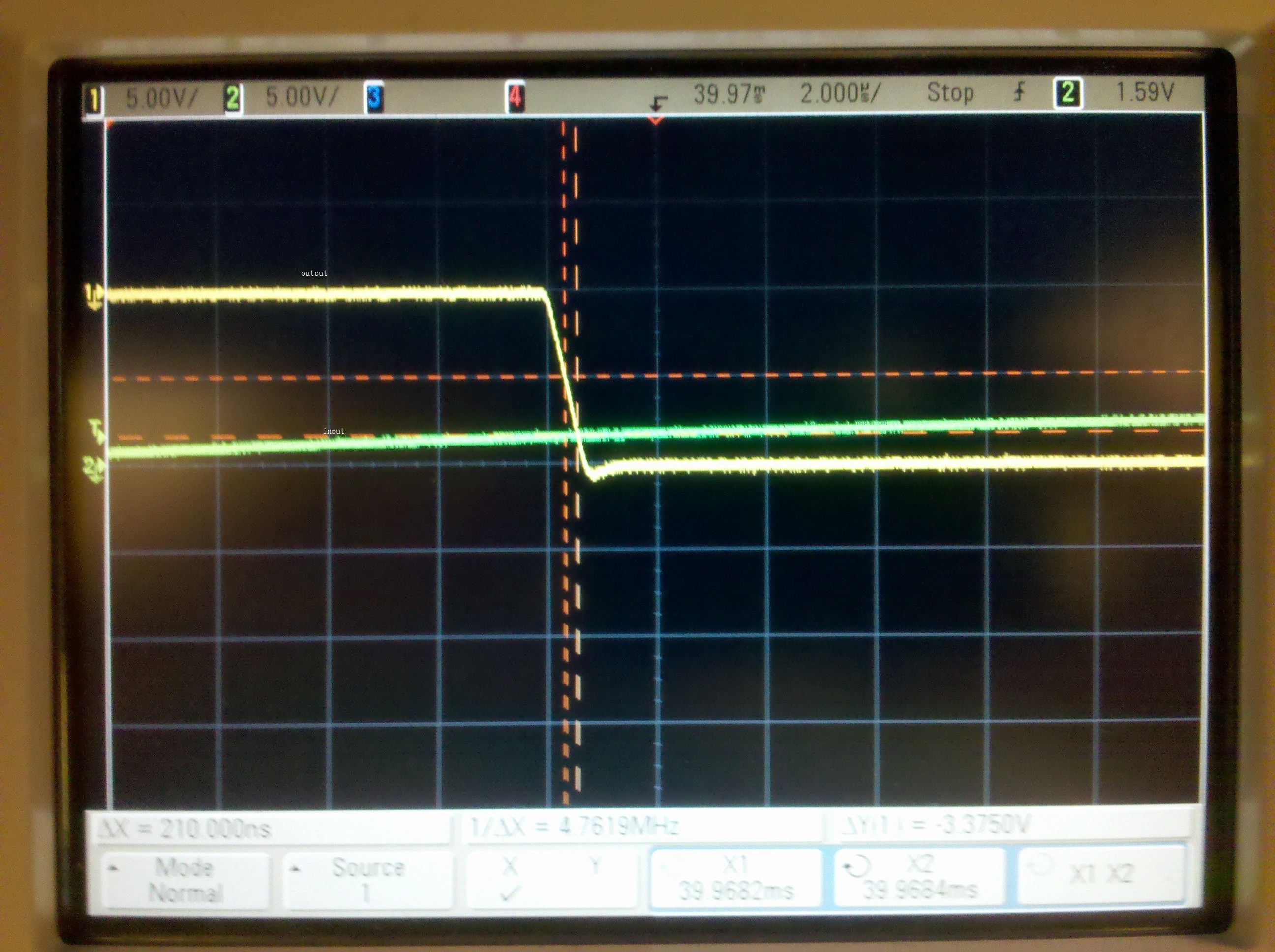

  • Hi Tony,
    Attached is the waveforms for the propagation delay and the settle time test. In the propagation delay waveform, the yellow one is the output and the green one is the input.

  • Yihong,
    Regarding the settling time and propagation delay - These specs are heavily dependent on the characteristics of your output amplifier. You will need a very fast amplifier that can settle fast in order to fully characterize the DAC. It looks from your pictures that your op amp slew rate could be what is limiting those measurements.
    -Tony
