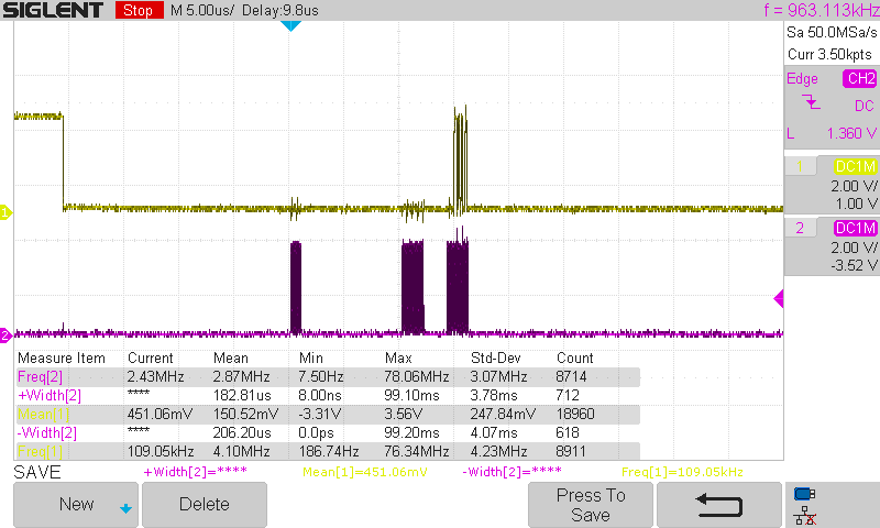

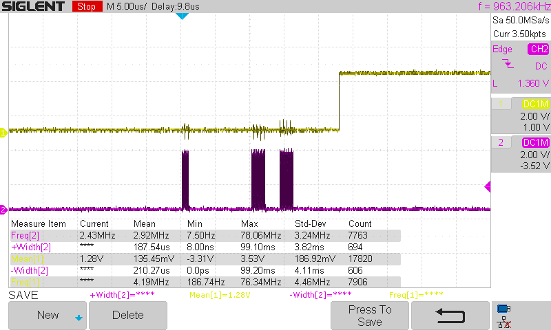

While dedicated DRDY pin works exactly as described, DOUT/DRDY pin works as described only if the last shifted bit from that pin during SPI transaction was “1” or high.
If the last shifted bit from DOUT/DRDY was 0, the DOUT/DRDY pin stays at “0” even when digitizing is not finished and when dedicated DRDY pin is high (this is in case I keep /CS low all the time).
If the last shifted bit from DOUT/DRDY was 0, when setting /CS high for a period of time after reading the data the DOUT/DRDY pin goes to “0” immediately after turning /CS low again even if the digitizing is not finished and dedicated DRDY pin is still high. That is causing a premature interrupt when /CS goes low.
Thank you very much for your time and help,
Anatoly
DOUT/DRDY (yellow, ch1) and SCLK (purple, ch2) when last shifted bit is “1”
DOUT/DRDY (yellow, ch1) and SCLK (purple, ch2) when last shifted bit is “0”

Thanks for your information. Did you start a new conversion by the START pin or by serial commands before you turn /CS low again?
You are reading the data highlighted in red, what's the operation for the SCLKs highlighted in blue? Are you using a voltage level to trigger an interrupt? a timing plot captured for the following frame is helpful.

Hi Dale,
Thank you for clarifying.
The blue data is OPCODE 0x12 and shift of the first two data bytes and the red are the last two bytes of the data. The transfer looks perfectly fine and for the transaction on the picture the STATUS and the CRC are disabled, so the entire transaction is 5 bytes.
The actual received data seems to be of high quality as expected.
The only situation I have since the last shifted bit is more or less always noise it is a random “0” or “1”, so when it is “0” then I cannot use data ready interrupt on this line.
