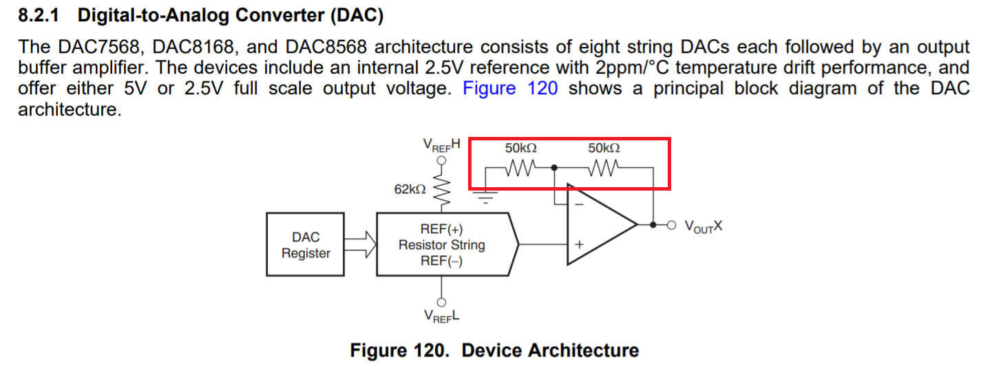

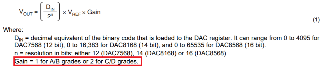

According to the datasheet , Vout formula is below. Gain is fixed by grade.
AVDD=5V and Internal VREF=2.5V then Gain=2 and output range is from 0 to AVDD
AVDD=5V and Internal VREF=2.5V , then Gain=1 and output range is from 0 to AVDD/2
And figure 120,I guess that both resistance 50kΩ of output amp set Gain=2 for C/D grades and  A/B grades has no  50kΩ resistance for buffer amp(Gain=1).
Is it correct?

    For C/D grade, its 2 and for others its set as 1 internally.
    Also output buffer is always set at gain 2 irrespective of the device grade, we have internally dividing the reference for A/B version so that total gain for DAC will be 1 in A/B version.

    Regarding data register corruption, I don't think this is causing the issue since you verified with multiple data write. Good thought to verify the same by writing into data register.
    Now I strongly believe that this issue is due to the gain setting only. But please understand that output output buffer is always in x2 configuration, its the internal string attenuation which defines the total gain. So believe that due to this high frequency noise, those switches might have flipped ( Just a thought). I will verify this with my design team and get back to you.

  • Hi Ttd,
    Its not related to the output buffer block, it has fixed gain of 2 whether you have A/B variant or C/D variant.
    Its the internal string resistor structure logic selection which is getting reset due to this very high frequency noise. Please be aware that at that high frequency noise, device PSRR will be negligible and all of this noise can couple into internal circuits. That's the reason I recommend filters on AVDD lines.
