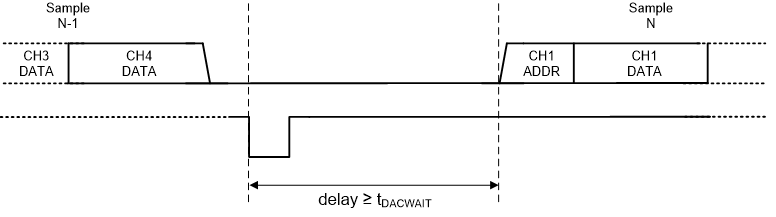

Do you have timing chart for tdacwait?

    Basically this is the time you need to give before you attempt to update the same channel with another data. ( Its the digital delay)
    Ch1 -- > Tdacwait ----> Ch1

    Is Tdacwait only needed when updating the same channel?
    I thought I needed Tdacwait for update different channels(CH1 --> Tdacwait --> CH3) with another data as well.
    Nishie
  • Hi Nishie,
    I checked this with my design team to clarify. Seems like this a common digital delay between transactions to free up the bus internally to the device.
    So you are correct, we need to wait Tdacwait for each channel update.

    Our customer has a CS high 80ns between a register updates to other register update.
    And it seems that the data is reflected normally.
    With reference to E2E thread "DAC81408: Timing for external LDACn inactive to CSn active.", I think the wait time needs 2.4us, but is 80ns okay?
    And could you tell me why the data is reflected with wait time = 80ns?

  • Hi Nishie,
    The tdacwait is the time interval between subsequent LDAC falling edges in synchronous mode or the interval between subsequent CS rising edges in asynchronous mode. Basically, the way tdacwait must be interpreted is as the delay between the latch edge and the CS falling edge of the next DAC command
    In the diagram below, second waveform is LDAC.
    hope this is clear, we will try to capture this in the datasheet in the next revision.

    tdacwait is only applicable for data register, not for settings registers like STATUS, SPICONFIG etc.
    and tdacwait has to be maintained or both synchronous and asynchronous updates.
    To get maximum throughput, send all data for the channels one after the other and use LDAC to update the DAC.
    after LDAC goes low, you need to give tdacwait time for next data update.
    Hope this is clear now.

    Settings registers are from 0x02h to 0x0Eh.
    There should not be any problem with CS high time being more than 50nS  for setting registers.

    I will set CS High time to more 50ns for setting register (from 0x02h to 0x0Eh).
    In additional I will set wait time to more 2.4us for other registers.
