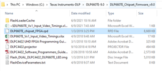

    Can you confirm what versions of ASIC and FPGA firmware images are you running on the EVMs? You can find the ASIC firmware version under System and the FPGA firmware under FPGA Control.
    I would assume that you already loaded the ASIC and FPGA firmware that is provided with the firmware download from https://www.ti.com/tool/DLP660TE-SW. If that is not the case then please do so. ASIC firmware programming instructions can be found in the DLPLCRDC4422EVM User's Guide and the FPGA firmware programming instructions can be found in the directory created during firmware package installation (see below).
  • ASIC firmware version:
    FPGA Firmware:
    We downloaded and installed the firmware for the dlp660 provided by ti.com. Above you can find screenshots from our GUI.
