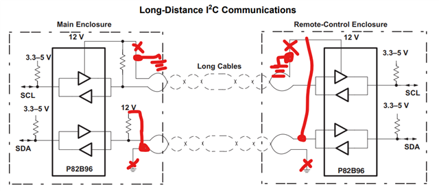

Hi Team,
The customer is asking that weather the twisted wired connection of GND and Vcc can exchange or not. Is there any concern? Thank you.
Mike
Hi Team,
Mike
Electrically, the SCL and SDA lines behave the same, so it does not matter which one gets paired with VCC or GND.
