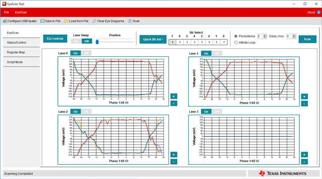

  • Hi David,
    Thank you for providing us with that firmware! We were able to update the device and are now using it to capture the received eye at the retimer. I have some updates to what we have observed so far below:
    Currently we are able to view outputs on the sinks as long as the resolution is capped to HDMI1.4 data rates but we do not get any video on the sink when running HDMI2.0 data rates.
    We have observed, while using TUSB3410, that for HDMI1.4 data rates the retimers are completing TMDS lane deskew.
    However, the retimers are unable to complete TMDS lane deskew when running HDMI2.0 data rates. The received eye for both cases look very similar so we were surprised that we did not see any output on the sink.
    I have attached some captures showing the received eye and status registers for both the passing(clock @300MHz and below) and failing cases(clock @346MHz and above).
    What could cause the retimers to fail completing the TMDS lane deskew and what impact does this have on the outputs of the retimer?

    Something is not right here. If the clock is 346MHz and the TMDS_CLK_RATIO_STATUS is 1/40, the actual data rate on each lane = 346 * 40 = 13.84G higher than what the DP159 can receive, this can cause the DP159 not able to de-skew the input data.
    For HDMI2.0, the clock rate is around 148.5MHz, which will give you around 6G data per lane.

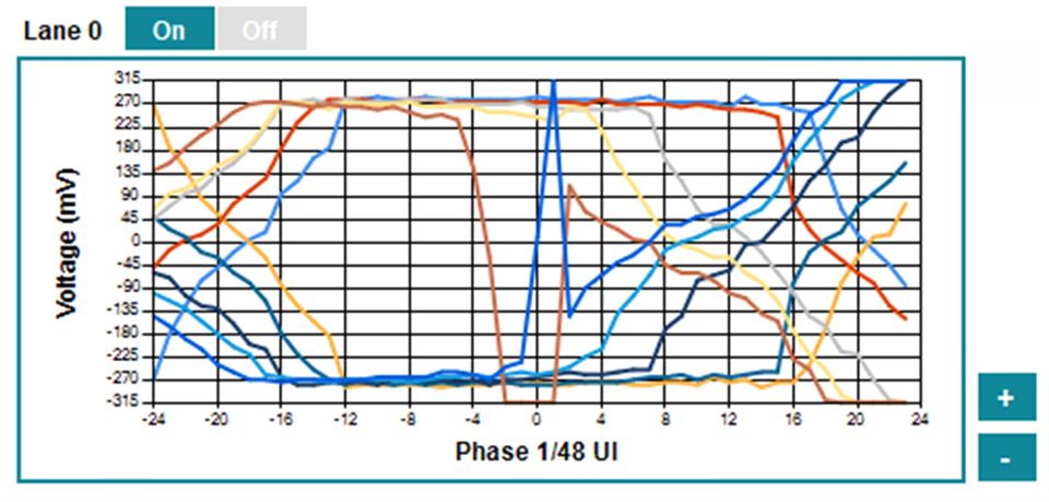

    Thank you for your assistance with this matter so far. Since the last update, we have discovered there was an error with the configuration of our Scramblers that caused bad data being transmitted which prevented the Retimer from completing the lane deskew function. We now have video working up to a pixel clock of 500MHz and any pixel clocks higher than this lead to artifacts and screen tearing.
    We still believe that we may have a signal integrity issue between the GPU and Retimers. We are seeing some weird behaviour with the EyeScan tool while using the tool to capture the received eye to help debug this problem. From the image below, it appears there is a discrepancy in the generation of the received eye.  It appears that the light blue line hit a floor while the yellow line hit a ceiling. After this brief interruption, the data resembles what we would expect from the rest of the eye. Also notice that the eye seems to be shifted to the left instead of being centered.
    This is a capture of eyes as we move from 300MHz up to 550MHz pixel clocks. This shows that as the speed increases, the eye keeps shifting to the left and at a pixel clock of 550MHz the discontinuity in the eye is introduced. We get this type of discontinuity in any eye capture at a pixel clock at or above 550MHz. I am not sure if this an error with the captured data or an error with the way the tool is rendering the data but I do not believe this is an accurate representation of the data. Is this something you have seen before? Or are we missing a setting somewhere in the tool when capturing eyes at these higher pixel clocks? Thanks again for your assistance with this issue and looking forward to hearing your thoughts.
    This is an issue with the EyeScan SW, please take a look at page 11 of the EVM user guide, https://www.ti.com/lit/ug/sllu228a/sllu228a.pdf.
    Are you using the DP150 adaptive equalization in your current testing?
    David

  • Hi David,
    Thank you for clarifying that for us. The below screenshot (raw data also attached) is a comparison of the received eye for adaptive eq vs eq off. In both of these configurations, we found that the settings of max Vswing and lowest de-emphasis on the GPU gives us the widest eye at retimer inputs. According to this capture, there is very little difference between eq off and adaptive eq. If you think enabling adaptive eq is the best settings for our configuration then we are happy to enable adaptive eq. From our research this eye should have enough height and width to properly pass video through the link. What are you thoughts on this? We are open to any additional feedback you may have and thanks again for your help with this issue.
    Current Retimer register settings starting at address 0x09h0x06 0x33 0x1B 0x61 0x00
    BestEyeSettings_Adeq_vs_eqoff.zip
    With the short trace between the GPU and the DP159, I would agree that you want the little or no pre-emphasis on TX and some equalization on the RX side, or some pre-emphasis on the TX side and little or no equalization on the RX side. For HDMI2.0 6Gbps, the estimate loss per inch is 0.6dB/in. Knowing the trace length, you can then estimate the amount of loss between the GPU and the DP159 and how much you have to compensate either through the pre-emphasis or equalizer.
    If you run the HDMI compliance testing on the DP159 TX side, are you still getting a HDMI2.0 compliant result with the current setting?
    Can you also probe the output clock and make sure the clock frequency is data_rate/4 for HDMI2.0?
