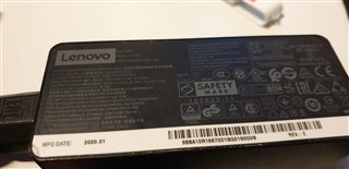

- I have two chargers wall adapters: one 5V 3A USB C dumb charger and one 65W adapter from lenovo (see photo)

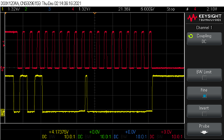

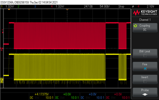

The result is the setup using the dumb 5V 3A input the device powers up and I get some i2c activity (see pictures). As you can see, in the second osci photo, the master writes to the EEPROM and the EEPROM gives an ACK which leads me to believe it has access to the flashed config.
However, with the 65W charger, it doesn't power up at all and probably doesn't load the EEPROM config.

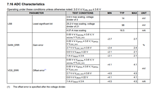

One of my issues in understanding is how to set the ADCx pins. I see the two diagrams below but I don't get how to divide the current so I am in the right "Mode".
Also, what would be the "right" "Mode" for my case?

  • The I2C traffic that you are describing after power up is the EEPROM boot sequence.  I can't decode it to be sure, but the general shape looks like it was a successful boot.
    The EEPROM is loaded in SafeMode.  This is reached by pulling ADCIN1 and ADCIN2 to GND.  This will set the I2C slave address of the TPS25750 to 0x21.
