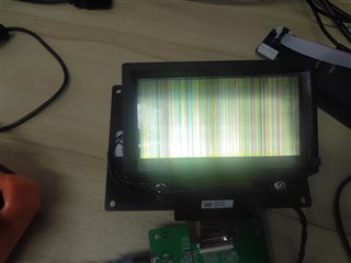

Customer use UH941 paired with UH928 is failed, the display is wrong.
But UH941 paired with UH948 is OK.
The schematics as attached.
Please help to review if there is anything wrong with customer design.

Hi Sir,
Here you are.
The setting of 941 and 928 also attached.
Thanks.

Hi Peter,
I am attaching a document with a comment regarding some recommendations on the schematic. In addition, I looked over the 941 Register settings and noticed that the active resolution was set to 1280x720. The specification for the LCD panel that was provided states that the supported resolution is 1280x640. Please adjust the active resolution to the appropriate vertical timings.
