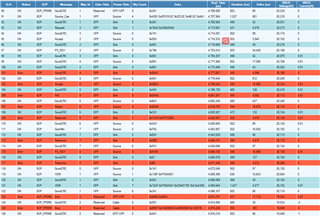

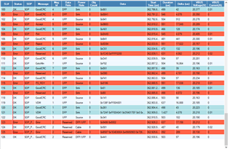

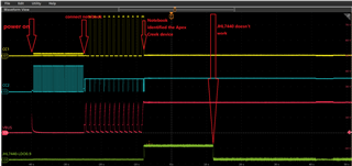

  • Update:
    I did the experiment again, and the process was as follows:
    1) : After connecting to the Notebook, wait for a while and the Notebook will recognize the Tapex Creek device as shown below.
    2) : At the same time, the Notebook starts slow charging (The Notebook supports 100W charging, and the maximum power of 65983B is 85W). At this time, the main control chip JHL7440 will have an internal 0.9V voltage output and crystal oscillator will work.
    3) : After a while, the internal 0.9V shuts down and JHL7440 does not work.
    I have attached PD log and I2C log of this whole process, please check.
    I didn't connect to any device and only connected to the Notebook through usB-C.
    Can you tell what the problem is from the log?
    TPS65983B-20220331-LOG.rar

  • Xiang,
    Yes I was able to open the I2C log now, but it looks to be looping the same read command over and over, and that read command does not show any faults on our device so the next step would be to check the waveforms and .pjt file.
    Taylor

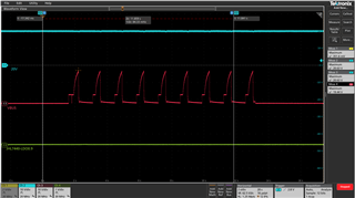

  • Dear Taylor:
    Attached are the PJT file and CC VBUS waveform I used, please help to check.
    The remarks for each action are as follows
    .pjt or waveforms.rar
  • Hi Xiang,
    Based on the waveform, it looks as if Vbus is struggling to meet PS_RDY requirements at 20V. Can you confirm your external Vbus 20V supply is stable and actually 20V? You can confirm by scoping on both sides of the PP_EXT portion of the schematic below.
    Taylor

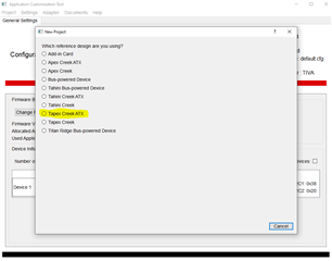

  • Jacob said I might need a virtual DP hot plug check when I use a single port.
    At present, my design does only use one USB-C port and does not use THE DP signal of JHL. Do I also need a virtual DP hot swap check? If yes, how to set it?

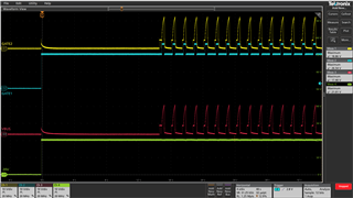

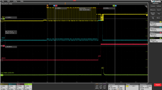

  • Dear Taylor:
    I have measured the VBUS and 20V power supply waveform, and it can be seen that there is no problem with 20V supply.
    I also used an electronic load meter to pull 20V, which can be stably pulled 20V@4.25A.
    Then I measured the waveform of 20V, VBUS, GATE1 and GATE2 as follows:
    I think it is the abnormal output of GATE signal inside PD that causes VBUS to fail to stabilize 20V.
    What do you think?
  • Xiang,
    Jacob confirmed you should enable the virtual DP port, and this can be done when you start a new Tapex creek project in the GUI, it will prompt you to select this option. As for this issue at hand, we detected several deviations from the reference design in your schematic which is likely contributing to these issues. So please refer to the above as the design should be used as is to avoid issues.
    Taylor

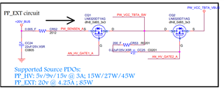

  • Dear Taylor:
    I have modified the schematic section to fit the reference design. The updated schematic diagram is in the attachment.
    According to the latest schematic design, it is still the same problem.
    If there are any other design differences, please let me know, thank you.

  • Dear Taylor:
    I found that a capacitor was not designed according to the reference value, and I have modified the capacitance value of the capacitor. The 20V-Vbus looks normal. The waveform is as follows:
    PD's log will still have an error.
    For PD logs and I2C logs, see the attached file.
    Can you see from I2C log why the main chip JHL7440 does not work?
    0408.rar
  • Xiang,
    Can you please clarify how you verified the redone schematic matches your board? I am just curious how you respun the board so quickly to include all the changes to match the reference design properly? If it was just blue wired from the previous board, there is risk there was damage done in the first version or other components missed like the example above that may not be fixed by just changing out a few components. I recommend starting with a new fresh board with the proper reference design schematic.
    Taylor
  • Dear Taylor:
    Capacitor problems directly replace the capacitor. RPD_G1,PRD_G2 and some MOS modifications are made by flying wire to match the reference design. Your concern is reasonable,I will verify with a new board and I will make sure that the components on the new board are not lost or damaged. If there is a problem, I will let you know next week.

  • Xiang,
    Did you try with the ATX .pjt and virtual DP setting in a new project? I could tell previously you did not use the ATX version.
    Taylor
  • Dear Taylor:
    I tried to use ATX's PJT and set up virtual DP detection. Using the default Settings, when connecting to notebook, the VBUS was only 5V and the main control was still not working. This PJT of ATX probably won't work.
    Although I used ATX power supply in my schematic, I did not refer to the Tapex Creek ATX design, but the Tapex Creek design. After startup, 20V will be directly supplied, which can be seen from the previous waveform.
    About PDlog, CC's communication about 20V voltage has been finished, but CC will still communicate. May I ask what is the communication about next? Solving the CC communication error problem may be a breakthrough point.
