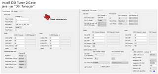

Hello team,
My customer use SOC-->SN65DSI83-->DS90UB927-->DS90UB928(display module) in their application.
Display company met flicker issue and insisted root cause is H-blank has variation at 928 LVDS output.
but 927/928 device use internal PCLK and sync with output so that this doesn't have variation.
So my customer question if SN65DSI83 device can generate Hblanking parameter variation a little.
Could you pls help me answer this to customer??

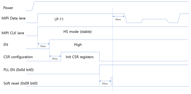

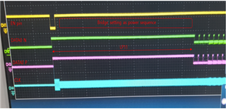

Attached is DSI tuner setting and timing info.
Thank you.
