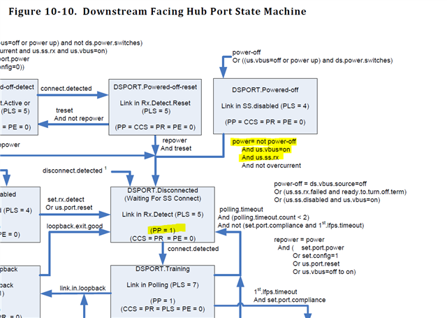

    I reviewed the DFP State Machine for the Hub, and see what you mean.
    I did want to point out the DSPORT.Powered-off -> DSPORT.Disconnected state change has an ambiguous comment regarding Rx.Detect and VBUS.
    Does the TUSB8041 actually check VBUS before presenting terminations, or is VBUS being ON "implied by Receiver Detection"??
    It almost seems like, if the Hub detects Termination on UFP, it assumes there must also be VBUS (UFP), and it could move to DSPORT.Disconnected.
    I would be curious how the TUSB8041 actually implements that check when it decides to Present Termination to the DFPs.

  • 1. Our hub will actually check for USB_VBUS, not all competitor hubs do.
    2. The internal PD on PWRCTLx/BATENx is disabled after the pin is sampled and switches to output mode.

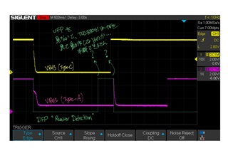

    1)
    I took a scope shot of UFP VBUS (PD Negotiated), and DFP VBUS(TUSB8041 Controlled) for the channel in question.
    The green line was added based on the Advisor T3 Logs - it is TERM = ON/OFF for DFP; and is turned on before UFP VBUS comes in...
    It's upwards of 600~800[ms] before the UFP VBUS comes up.
    If the TUSB8041 can't turn on TERM until it detects UFP VBUS, but there is none...???
    That is the question.

  • Hi Darren,
    1. Can you share the Advisor logs?  That doesn't match up the hub design.  Even if the hub ignored USB_VBUS, the DFP wouldn't turn on terms unless the host was enabling its terms on an unpowered port?
    2. No, the PWRCTL outputs aren't high-z, they will either be high or low.
    JMMN
  • Hi Julie,
    1) I tried getting some logs again, but for some reason couldn't replicate the TERM-before-VBUS behavior.
    Instead, Terminations followed the VBUS.
    The attached Presentation shows the two cases -> Good vs Bad.
    It looks like the issue really is that VBUS glitch...I'll see how to get an Analyzer on the UFP.
