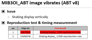

Here is measurement result as you requested.it shows 23.276us.
They OLDI output is 61MHz, so 1/61MHz*1420(Htotal)=23.278us. so I understand DSI input doesn't show problem.
and only 2 pixel of front porch is shifted to back porch when issue happen as below table.(normal : 50/50 for front/back porch, flicker issue case: 48/52 for front/back porch value could be found)

    The scope shot in the attached presentation, are they taken with a good unit or the bad unit?
    David
  • Hello David,
    Those scope shot is from bad unit. but it is very hard to reproduce issue with issue sample in LG hand. because they have sent one high failure rate issue sample. As LG reported, each sample has different failure rate. (1~2/10times power on/off test from issue sample in your hand, but other issue sample only has 1~2 times failure rate per 500~1000times or more on/off test).
    LG have tested as below item by themselves. FYI.
    1) change 0x29 to adjust Sync delay ==> has issue. (issue means H front porch/H back porch has variation)
    2) change PCLK ==> has issue (issue means H front porch/H back porch has variation)
    3) change H blanking parameter  ==> has issue (issue means H front porch/H back porch has variation)

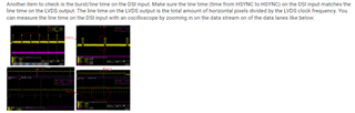

    If you look at the Troubleshooting SN65DSI8x - Tips and Tricks App note, https://www.ti.com/lit/an/slla356/slla356.pdf, the DSI8x does not realign timing, so if the line time is different then there will be issues.
    David

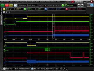

  • Hello David,
    pls refer to attached for your request.
    I added line time. and both line time are measured in same scope window.
    I believe they have same line time.( pls note it could have measurement tolerance with several nano seconds.)
    pls refer to page #5~7
    MIB3_OI_LGE_ABT image vibrates_for ti_20221014.pptx
    Thank you.

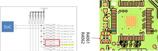

    • The connector that connects to the display is not key’ed, which orientation is the right way to plug the connector into the display?
    • There is a yellow and a purple color connector on the main DSI83-Q1 board, can you please confirm the display cable needs to be plugged into the purple connector?
    • Visual inspection shows there are damaged component on the main DSI83-Q1 board (see below picture), please confirm if they need to be fixed first.
    Thank you

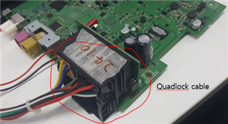

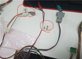

  • Dear. Sir,
    Please refer to below picture.
    I've already shared it by email, but I'm sharing it again.
    1. The display cable direction is the same as the picture below.
    2. Connect the quadlock cable to the PCB.
    3. Display cable connection
    4. After connecting the display, connect the power supply to the part indicated below on the Quadlock cable and apply 14V.
    And, Damaged parts are related to Ethernet function, so there is no problem in display test.
    So, I look forward to your reply as soon as possible.
    Thanks.
    Best regards, Kumin

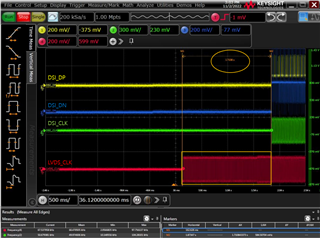

    Thanks for the setup instruction. Following the setup instruction and powering the board with 14V, I still do not see display lights up.
    I did however checked DSI83-Q1 power up sequence, below is the screen shot.
    Channel 1 - VCC
    Channel 2 - DSI_CLK
    Channel 3 - EN
    What I noticed is the DSI_CLK is not in HS CLK mode. Is it possible to configure the DSI source so the clock is in HS CLK mode? This is part of the DSI83-Q1 power up sequence requirement.

    "What I noticed is the DSI_CLK is not in HS CLK mode. Is it possible to configure the DSI source so the clock is in HS CLK mode? This is part of the DSI83-Q1 power up sequence requirement."
    Thanks.
    Best regards, Kumin.
  • Kumin
    I will provide the setup picture tomorrow.
    For HS CLK mode, please refer to this scope plot. You want to make sure the DSI CLK is already running in the DSI High Speed mode when EN pin goes from low to high.
    David
  • Dear. David
    Thank you for your reply.
    I heard LGE SW engineer already revised power sequence as you mentioned, but Issue was occured.
    And, I checked yesterday, When the issue was occured, V_active_width, V_Period was shaking mainly. (H_porch is also unstable)
    Please refer to attached picture.
    So, I will check Scope cauptre one more when the issue is occured soon.

  • Kumin
    Please see below for the connection picture.
    Could you please ask LGE SW engineer to double check the DSI83-Q1 power-up sequence? We need to make sure the correct power-up sequence is being followed.
    David

  • Dear. David
    I plan to check the power sequence by measuring it with an oscilloscope today.
    And, In the picture below, the cables are connected in reverse.
    I have a question as below.
    If you look at the waveform below, when booting, LVDS_CLK initially oscillates at about 3 MHz for 1.7 seconds and then oscillates at 62 MHz.
    It isn't not LGE SW setting.
    Is it normal to oscillate at 3 MHz?
    Thanks.
  • Kumin
    I am now able to get the display working with the change in the cable orientation.
    For your scope capture, can you also probe the DSI83-Q1 EN pin and see when it is toggling from low to high along with the DSI_CLK and LVDS CLK?
    David

    Regarding the I2C access.
    I guess I2C to SoC need be disconnected by removing R4062/4061 on below
    Thanks, I requested to replace the two resistors with jumper. The jumper will be populated so the DSI83-Q1 can be programmed first upon power up. Once it is powered up, then I will use the jumper to switch to the external I2C controller.
