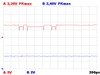

Could you conduct some lab tests to gather a scope capture of COM1-RX-B, USART1-RX, USART1-PRCTL, and /INVALID? Thanks!
Tyler
Hi Tyler,

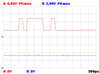

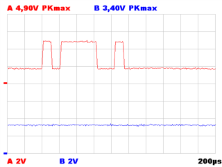

Here are the requested captures, sorry I have only 2 channels on my Fluke 225C, so I repeated capture by always including COM1-RX-B as channel A. Also note that there is USART1-PRCTL and /USART1-PRCTL (I've not captured the later since they are static in the test, it is a simple BJT/resistors inverter).
In my tests, I've noted that signal coming from MAX13487 pin RO is arround 3.9V so I suspect a long term issue there, but tried powering it at 3.3V, same behaviour but the chip is not rated for this power rail. It will be replaced by THVD1406DR which will be at 3.3V, they are ordered but will receive them only in about a week.
A: COM1-RX-B B: USART1-RX
A: COM1-RX-B B: USART1-PRCTL
A: COM1-RX-B B: /INVALID
Thank you,
Alexandre.

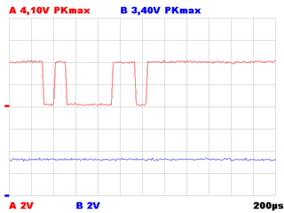

One more scope request. Can you gather CH1 = USART1-RX, CH2 = USART1-PRCTL?
Remind me again, /USART1-PRCTL is the same signal as USART1-PRCTL just inverted?
Tyler
Hi Tyler,
Here is the new capture :
Yes /USART1-PRCTL is just the inverted signal of USART1-PRCTL, currently USART1-PRCTL is tied to 3.3V and there is a 2N2222 with two resistors of 10K doing the inversion to generate /USART1-PRCTL as this schematic include :

Given that USART1-PRCTL = /EN is HIGH, it doesn't make sense that there is still an output signal on USART1-RX = ROUT. However, looking at your schematic, USART1-RX shares the output of RO on the MAX13487EESA. Are we sure that the 13487 is not generating an output signal that could be mistaken for the output of the MAX3221?
Could we try another test. Cut the 5V supply to the MAX13487, assure that it is in the off state. Make sure the /EN pin is LOW. Then input a valid RS232 signal on Pin 8 = COM1-RX-B = RIN, see if you read the correct digital output on pin 9 = USART1-RX = ROUT. Then repeat the test ensuring that /EN is HIGH.

I find the behavior as odd as you. I've designed this circuit part according to both datasheets. I've ran some tests :
1. Connect only MAX13487 RO to USART1-RX, works as indented, no echo in RS-485 mode in both directions
2. Connect only MAX3221 ROUT to USART1-RX, works as indented, no echo in RS-485 mode in transmit only of course
3. Keep connections, but leave MAX13487 VCC floating, works as indented in RS-485 mode (in both directions!!!!), but I see spikes on USART1-RX, still they are too short and I receive nothing on serial port, see capture
There is a conflict between MAX3221 ROUT and MAX13487 RO, for now I would put this on hold, wait reception of THVD1406DR that I would use instead of MAX13487 and also power it at 3.3V, that's my hope for the moment. I should receive them next week so I will give you update about results!
