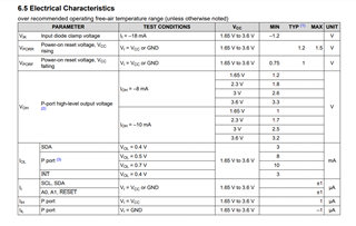

TCA9539-Q1: TCA9539QPWRQ1 VOH of IO @3.3V and equivalent internal structure of IO
Part Number: TCA9539-Q1
Hello Teams,
There are some questions for TCA9539QPWRQ1 , please help me to confirm:
1. What is the voltage of VOH if the voltage of VCC is 3.3V?
2. In the datasheet, when VCC is 3V, VOH is 2.6V @8mA; when VCC is 2.3V, VOH is 1.8V @8mA;. So can I assume  there is a equal pull-up resistor as equivalent internal structure of IO in the chip?
