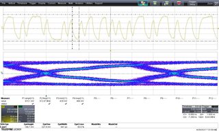

I have the following setup (1x DP83869HM in bridge-mode, 1x DP83869HM in SGMII-to-Copper mode):
I measured signal integrity (with a 5 GHz differential probe and 6 GHz scope) at the input of SGMII-to-Copper PHY (after AC-caps):
These are my results:
My questions are:
- How to know, if e.g. sample position "B" is a period of 1-1-1 or if this is a period of 1-0-1 but the zero voltage level is not reached.
- What is the SGMII input voltage treshold specification? I can't find this spec in the datasheet
- In the DS the SGMII output is specified with Output Differential Voltage = 1060 (min) / 1100 (typ) / 1140 (max)
--- At the receiver the SGMII-signal is only between -400mV to 400 mV (800mV)
------ Does it mean that I have significant losses on the transmission lines?

  • HEy Lin,
    sorry for my late response! I measured eye diagrams now, for RX and TX-side.
    Please see attachments...
    RX-side (after AC-caps of SGMII-to-Copper PHY; left side of the above picture) with iperf running:
    TX-side (after AC-caps of RGMII-to-SGMII bridge PHY; right side of the above picture) with iperf running:
    Would be great to get a feedback about the signal integrity and if this diagrams lead to a solid interfacing between the two PHYs.
    Thx in advance!

  • Here now some eye-diagram information, see picture:
    On the bottom red box of the picture, some measurement data from the scope is also shown.
    Sorry, I'm not very familiar with eye-diagrams, so please help me to interpret my measurements.
    Thanks in advance!
    Julian

    The amplitude or peak to peak between the signal should be greater than +/- 100mV. However, from the eye diagrams you send me, I see that your peak to peak only goes up to +/- 90mV. Are you able to increase the output driver level on the MAC side?

    First of all, my notes on the eye diagram were wrong, it is +-180mV, not +-90mV:

    I don't get why you want me to do this. All required information is in the already posted picture.
    Eye-Height=+/- 180mV
    Eye-Width=677ps

    Please do follow the mask requirement I send you earlier for SGMII signal specification
    I did this. I'm in spec, but quite close regarding eye-opening for 0.25UI, as shown in my diagrams.
