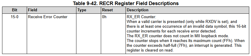

What is maximum value for RECR (RX_ER Counter)? At datasheet is stated value 0xFF, but register is 16-bit? I think this is typo from previous register FCSCR which is 8bit.

  • Hi Jan,
    Are you getting more errors than FF? What are you intending on using this register for?
    Melissa
  • Hi Melissa,
    I want to use registers RECR and FCSCR as were intended by design. That means for assessment of link quality of my new design and later at the field.
    Yes, I see higher value than 0xFF inside RECR register. At this time I testing with DP83825 (DP83825EVM) and later when I will have own hardware ready I want to use DP83826. It looks that mistake with RECR is at datasheets for other DP8382x devices as well:
