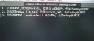

  • Dear Dacid,
    1. If R492 R453 is deleted, the negotiation succeeds, but udhcp cannot obtain the IP address
    2. Connect PIN22 to DC3V3D_MAC. The IP address cannot be obtained from udhcp
    3. Connect PIN1 to the GDN. udhcp cannot obtain the IP address

    What do you mean "If R492 R453 is deleted"? Does that mean DNP? How, then, is the PHY getting any reference clock?
    My first guess here is that strapping is the issue. The PHY must be configured to RMII slave mode to operate off a 50Mhz oscillator connected to XI pin. If you are not doing this in software, it must be done through bootstraps. Please have a look at section 9.4.1.1 of the datasheet to determine how to strap in RMII slave mode.
    David
  • Dear David,
    Sorry for my mistake,Remove the R492 in the PCBA and add the R453 in the PCBA.
    For 50MHZ,Customer feedback that the SOC have provide 50MHZ pulse,so the schematic have issue or not?
  • Hi Ning,
    This is an issue. R492 should not be connected in RMII slave mode (R453 should be connected). Please see section 9.3.10 of the datasheet for the difference between RMII master and RMII slave mode.
    Looking at your schematic, you are strapped into MII mode. This explains why communication is not working. Please strap the device to RMII slave mode (or set it through register write).
    David

  • Hi Ning,
    What changes were made to optimize the hardware? I need to know which MAC interface the customer wants to use, not just the MAC name. Do they want MII, RMII slave mode, RMII master mode, etc.?
    David
  • Dear David,
    1.They refer to 9.4.1 hardware configuration,Add pull up resister 2.49K in PIN 14,PIN20,PIN22,now they want to know whether the hardware have any problem or not? If the hardware have no problem,they will check the software. So pls kindly help to check the changed schematic
    2.For work mode,The hardware boot configuration is as follows:ENHANCED 、RMII 、slave mode.
    PIN1:1
    PIN28:0
    PIN29:0
    PIN30:1
    PIN14:1
    PIN13:0
    PIN22:1
    PIN15:0
    PIN16:0
    PIN18:0
    PIN20:1
    3.For Mac,now the Phy can connect but no net,and anyka want to konw  whether the specific requirements for the mac or not?
    AJB_DP83826.pdf
  • Hi David,
    BTW,pls kindly help to check the  register data too after they optimized the hardware.

    [20230321_17:54:29]ak-spinand spi0.0: GD5F1GQ5UEY1G (131072 Kbytes)
    [20230321_17:54:29]Scanning device for bad blocks
    [20230321_17:54:29]10 cmdlinepart partitions found on MTD device spi0.0
    [20230321_17:54:29]Creating 10 MTD partitions on "spi0.0":
    [20230321_17:54:29]0x000000000000-0x000000020000 : "SPL"
    [20230321_17:54:29]0x000000020000-0x000000040000 : "ENV"
    [20230321_17:54:29]0x000000040000-0x000000060000 : "ENVBK"
    [20230321_17:54:29]0x000000060000-0x000000080000 : "DTB"
    [20230321_17:54:29]0x000000080000-0x0000000c0000 : "UBOOT"
    [20230321_17:54:29]0x0000000c0000-0x000000260000 : "KERNEL"
    [20230321_17:54:29]0x000000260000-0x0000002c0000 : "LOGO"
    [20230321_17:54:29]0x0000002c0000-0x000000cc0000 : "ROOTFS"
    [20230321_17:54:29]0x000000cc0000-0x0000016c0000 : "CONFIG"
    [20230321_17:54:29]0x0000016c0000-0x0000022c0000 : "APP"
    [20230321_17:54:29]Init AK SPI Flash finish.
    [20230321_17:54:29]akspi master SPI0 initialize success, use for PIO mode.
    [20230321_17:54:29]i2c /dev entries driver
    [20230321_17:54:29]ak_wdt_init: watchdog register...
    [20230321_17:54:29]NET: Registered protocol family 17
    [20230321_17:54:29]sctp: Hash tables configured (established 512 bind 1024)
    [20230321_17:54:29]hctosys: unable to open rtc device (rtc0)
    [20230321_17:54:29]ak37e_clk: reset_module:0xf0008020 @ 7
    [20230321_17:54:29]
    [20230321_17:54:29]yaffs: dev is 32505863 name is "mtdblock7" ro
    [20230321_17:54:29]yaffs: passed flags ""
    [20230321_17:54:30]VFS: Mounted root (yaffs2 filesystem) readonly on device 31:7.
    [20230321_17:54:30]devtmpfs: mounted
    [20230321_17:54:30]Freeing unused kernel memory: 140K
    [20230321_17:54:30]random: init: uninitialized urandom read (4 bytes read, 9 bits of entropy available)
    [20230321_17:54:30]random: rcS: uninitialized urandom read (4 bytes read, 11 bits of entropy available)
    [20230321_17:54:30]mount all file system...
    [20230321_17:54:30]random: mkdir: uninitialized urandom read (4 bytes read, 13 bits of entropy available)
    [20230321_17:54:30]random: mount: uninitialized urandom read (4 bytes read, 13 bits of entropy available)
    [20230321_17:54:30]**************************
    [20230321_17:54:30]    Love Linux ! ! !
    [20230321_17:54:30]random: hostname: uninitialized urandom read (4 bytes read, 13 bits of entropy available)
    [20230321_17:54:30]random: rc.local: uninitialized urandom read (4 bytes read, 13 bits of entropy available)
    [20230321_17:54:30]/bin/mount -t yaffs2 /dev/mtdblock9 /usryaffs: dev is 32505865 name is "mtdblock9" rw
    [20230321_17:54:30]
    [20230321_17:54:30]yaffs: passed flags ""
    [20230321_17:54:31]/bin/mount -t yaffs2 /dev/mtdblock8 /etc/configyaffs: dev is 32505864 name is "mtdblock8" rw
    [20230321_17:54:31]
    [20230321_17:54:31]yaffs: passed flags ""
    [20230321_17:54:31]starting mdev...
    [20230321_17:54:31]~ # start telnet......
    [20230321_17:54:31]                     __
    [20230321_17:54:31]            _   ____ \/ ____  __
    [20230321_17:54:31]     /\    | \ | |\ \  / /| |/ /    /\
    [20230321_17:54:31]    /  \   |  \| | \ \/ / | ' /    /  \
    [20230321_17:54:31]   / /\ \  | . ' |  \  /  |  <    / /\ \
    [20230321_17:54:31]  / ____ \ | |\  |  |  |  | . \  / ____ \
    [20230321_17:54:31] /_/    \_\|_| \_|  |__|  |_|\_\/_/    \_\
    [20230321_17:54:31]
    [20230321_17:54:32]ak_uio: register uio device successfully with irq: 26!
    [20230321_17:54:32]ak_uio: register uio device successfully with irq: 23!
    [20230321_17:54:32]ak_mac Ethernet Driver
    [20230321_17:54:32]ak_mac_probe, line:5808, mac_id:1
    [20230321_17:54:32]insmod mac device ok
    [20230321_17:54:32]eth0 owns a shared interrupt on netdev->irq 31
    [20230321_17:54:32]setting up the cable unplug timer1 for mac1
    [20230321_17:54:32]udhcpc: started, v1.30.1
    [20230321_17:54:32]udhcpc: sending discover
    [20230321_17:54:34]Autonegotiation Complete,loop_count:99999
    [20230321_17:54:34]XZJ read reg:0x0 : 0x3100
    [20230321_17:54:34]XZJ read reg:0x1 : 0x786d
    [20230321_17:54:34]XZJ read reg:0x2 : 0x2000
    [20230321_17:54:34]XZJ read reg:0x3 : 0xa130
    [20230321_17:54:34]XZJ read reg:0x4 : 0x1e1
    [20230321_17:54:34]XZJ read reg:0x5 : 0xcde1
    [20230321_17:54:34]XZJ read reg:0x6 : 0xf
    [20230321_17:54:34]XZJ read reg:0x7 : 0x2001
    [20230321_17:54:34]XZJ read reg:0x8 : 0x0
    [20230321_17:54:34]XZJ read reg:0x9 : 0x0
    [20230321_17:54:34]XZJ read reg:0xa : 0x100
    [20230321_17:54:34]XZJ read reg:0xb : 0x0
    [20230321_17:54:34]XZJ read reg:0xc : 0x0
    [20230321_17:54:34]XZJ read reg:0xd : 0x401f
    [20230321_17:54:34]XZJ read reg:0xe : 0x2c9f
    [20230321_17:54:34]XZJ read reg:0xf : 0x0
    [20230321_17:54:34]XZJ read reg:0x10 : 0x615
    [20230321_17:54:34]XZJ read reg:0x11 : 0x108
    [20230321_17:54:34]XZJ read reg:0x12 : 0x6400
    [20230321_17:54:34]XZJ read reg:0x13 : 0x2800
    [20230321_17:54:34]XZJ read reg:0x14 : 0x0
    [20230321_17:54:34]XZJ read reg:0x15 : 0x0
    [20230321_17:54:34]XZJ read reg:0x16 : 0x100
    [20230321_17:54:34]XZJ read reg:0x17 : 0xe5
    [20230321_17:54:34]XZJ read reg:0x18 : 0x400
    [20230321_17:54:34]XZJ read reg:0x19 : 0xcc01
    [20230321_17:54:34]XZJ read reg:0x1a : 0x0
    [20230321_17:54:34]XZJ read reg:0x1b : 0x7d
    [20230321_17:54:34]XZJ read reg:0x1c : 0x5ee
    [20230321_17:54:34]XZJ read reg:0x1d : 0x0
    [20230321_17:54:34]XZJ read reg:0x1e : 0x102
    [20230321_17:54:34]XZJ read reg:0x1f : 0x0
    [20230321_17:54:34]XZJ read reg:0x468 : 0x2c9f
    [20230321_17:54:34]XZJ read reg:0x467 : 0x164
    [20230321_17:54:34]ak_gmac_check_phy_init 4410, enter
    [20230321_17:54:34]ak_gmac_check_phy_init 4429, Speed reg val:0xf
    [20230321_17:54:35]udhcpc: sending discover
    [20230321_17:54:38]udhcpc: sending discover
    [20230321_17:54:41]Usage: /usr/share/udhcpc/default.script {bound|renew|deconfig}
    [20230321_17:54:46]~ # ifconfig
    [20230321_17:54:46]eth0      Link encap:Ethernet  HWaddr 2A:8B:87:37:39:88
    [20230321_17:54:46]          UP BROADCAST RUNNING MULTICAST  MTU:1500  Metric:1
    [20230321_17:54:46]          RX packets:95 errors:0 dropped:39 overruns:0 frame:0
    [20230321_17:54:46]          TX packets:3 errors:0 dropped:0 overruns:0 carrier:0
    [20230321_17:54:46]          collisions:0 txqueuelen:1000
    [20230321_17:54:46]          RX bytes:22500 (21.9 KiB)  TX bytes:1026 (1.0 KiB)
    [20230321_17:54:46]          Interrupt:31 Base address:0x8000
    [20230321_17:54:46]
    [20230321_17:54:46]lo        Link encap:Local Loopback
    [20230321_17:54:46]          inet addr:127.0.0.1  Mask:255.0.0.0
    [20230321_17:54:46]          UP LOOPBACK RUNNING  MTU:65536  Metric:1
    [20230321_17:54:46]          RX packets:0 errors:0 dropped:0 overruns:0 frame:0
    [20230321_17:54:46]          TX packets:0 errors:0 dropped:0 overruns:0 carrier:0
    [20230321_17:54:46]          RX bytes:0 (0.0 B)  TX bytes:0 (0.0 B)
    [20230321_17:54:46]
    [20230321_17:54:51]~ #
    [20230321_17:55:01]~ # udhcpc: sending discover
    [20230321_17:55:04]udhcpc: sending discover
    [20230321_17:55:07]udhcpc: sending discover
    [20230321_17:55:10]Usage: /usr/share/udhcpc/default.script {bound|renew|deconfig}
    [20230321_17:55:15]Autonegotiation Complete,loop_count:99999
    [20230321_17:55:15]XZJ read reg:0x0 : 0x3100
    [20230321_17:55:15]XZJ read reg:0x1 : 0x786d
    [20230321_17:55:15]XZJ read reg:0x2 : 0x2000
    [20230321_17:55:15]XZJ read reg:0x3 : 0xa130
    [20230321_17:55:15]XZJ read reg:0x4 : 0x1e1
    [20230321_17:55:15]XZJ read reg:0x5 : 0xc5e1
    [20230321_17:55:15]XZJ read reg:0x6 : 0xf
    [20230321_17:55:15]XZJ read reg:0x7 : 0x2001
    [20230321_17:55:15]XZJ read reg:0x8 : 0x0
    [20230321_17:55:15]XZJ read reg:0x9 : 0x0
    [20230321_17:55:15]XZJ read reg:0xa : 0x100
    [20230321_17:55:15]XZJ read reg:0xb : 0x0
    [20230321_17:55:15]XZJ read reg:0xc : 0x0
    [20230321_17:55:15]XZJ read reg:0xd : 0x401f
    [20230321_17:55:15]XZJ read reg:0xe : 0x164
    [20230321_17:55:15]XZJ read reg:0xf : 0x0
    [20230321_17:55:15]XZJ read reg:0x10 : 0x4e15
    [20230321_17:55:15]XZJ read reg:0x11 : 0x108
    [20230321_17:55:15]XZJ read reg:0x12 : 0xe600
    [20230321_17:55:15]XZJ read reg:0x13 : 0x2800
    [20230321_17:55:15]XZJ read reg:0x14 : 0x0
    [20230321_17:55:15]XZJ read reg:0x15 : 0x0
    [20230321_17:55:15]XZJ read reg:0x16 : 0x100
    [20230321_17:55:15]XZJ read reg:0x17 : 0xe5
    [20230321_17:55:15]XZJ read reg:0x18 : 0x400
    [20230321_17:55:15]XZJ read reg:0x19 : 0xcc01
    [20230321_17:55:15]XZJ read reg:0x1a : 0x0
    [20230321_17:55:15]XZJ read reg:0x1b : 0x7d
    [20230321_17:55:15]XZJ read reg:0x1c : 0x5ee
    [20230321_17:55:15]XZJ read reg:0x1d : 0x0
    [20230321_17:55:15]XZJ read reg:0x1e : 0x102
    [20230321_17:55:15]XZJ read reg:0x1f : 0x0
    [20230321_17:55:15]XZJ read reg:0x468 : 0x2c9f
    [20230321_17:55:15]XZJ read reg:0x467 : 0x164
    [20230321_17:55:15]ak_gmac_check_phy_init 4410, enter
    [20230321_17:55:15]ak_gmac_check_phy_init 4429, Speed reg val:0xf
    [20230321_17:55:30]udhcpc: sending discover
    [20230321_17:55:33]udhcpc: sending discover
    [20230321_17:55:37]udhcpc: sending discover
    [20230321_17:55:37][20230321_17:55:37]
  • Hi Ning,
    In the text file, I see eth0 is up and:
    "RX packets:95 errors:0 dropped:39 overruns:0 frame:0
    collisions:0 txqueuelen:1000"
    What line in the file shows "but no net"?
    Can you perform a ping command?
    David
  • Dear David,
    They have solve the problem,so you can close the case.
  • Hi Ning,
    Can you please share what the solution was?
    David
