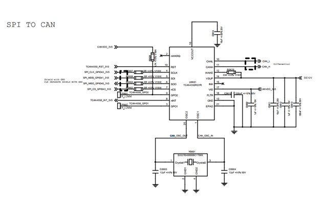

TCAN4550: Application issues of chips
Part Number: TCAN4550
Testing TCAN4550 is normal for sending and receiving standard frames ten thousand times, but when testing extended frames, TCAN4550 is unable to receive extended frame data and can send extended frames. Is there anything else that needs to be configured for the driver?

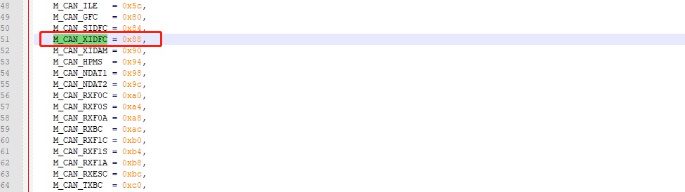

    M_CAN_GFC    = 0x80,
    M_CAN_SIDFC    = 0x84,
    M_CAN_XIDFC    = 0x88,
    M_CAN_XIDAM    = 0x90,

    /* XID */
    if (cdev->version == 30) {
        //TCAN4550_DBG("$$$$$$ read M_CAN_XIDFC 0x%X\n", m_can_read(cdev, M_CAN_XIDFC));
        //TCAN4550_DBG("$$$$$$ write M_CAN_XIDFC 0x%X\n", (1 << TXBC_NDTB_SHIFT) |
        //        cdev->mcfg[MRAM_XIDF].off);
        m_can_write(cdev, M_CAN_XIDFC, (1 << TXBC_NDTB_SHIFT) |

  • The driver code you have provided doesn't contain any information about how the TCAN4550 is being configured.
    - Can you provide your device tree binding and in particular the MRAM configuration?
    - Are you using Classical CAN frames, or CAN FD frames?
    - What are the Nominal and Data bit rates?
    - You mention you are unable to send and receive extended frames.  Are you getting any type of error messages, are you monitoring the error counters, or status registers for Bus Off conditions, or are you directly observing the CAN bus with a scope, etc.?
    Jonathan

  • At present, after setting the XIDFC register, we can send and receive extended frames. However, when connecting three devices, the third device failed to send. Can you help analyze where the problem is? Do you still need to set other registers?
  • Ok, so it looks like you are using message ID filtering and the XIDFC register configures how many filter elements you are using and the MRAM start address for the first filter element.  What did you set this register to?  You should note that each filter element enabled must a filter configured into and it can't be left blank.  This is because when a message is received without error, the MCAN controller will first scan all of the filter elements starting at the first element and see if the message passes one of the filters.  If it does it will be stored in a MRAM RX FIFO or RX New Data buffer element per that particular filter's configuration.  Any unused filter elements that don't contain valid data will result in an error during this process.
    When using filters, you need to set the Extended ID AND Mask (XIDAM) register and the Global Filter Configuration (GFC) registers.  Standard ID Filter Configuration (SIDFC) register likewise needs to be configured for any SID filters you have.
    As part of your initialization and configuration procedure, you will then need to actually write the filter elements to the MRAM space you have allocated in the previously mentioned registers.  The SID and XID Filter elements determine what to do with matching messages.
    More detailed information can be found in the M_CAN User's Manual written by Bosch for this controller IP that is included in the TCAN4550.  Sections 2.3 and 2.4 cover the registers and MRAM configuration for the different types of buffer and filter elements.  You can find it at the following link.
    https://www.bosch-semiconductors.com/media/ip_modules/pdf_2/m_can/mcan_users_manual_v331.pdf
    If you want to receive all messages that don't match a filter, or you do not want to filter messages at all, you should be able to configure the device to accept all messages that don't match a filter into one of the two RX FIFOs.  In this way you will still receive all RX messages.  This is configured in the Global Filter Configuration (GFC) register.
    Jonathan
    What value did you set to the XIDFC (0x1088) register?  Can you also share the values of the SIDFC (0x1084), GFC (0x1080), Extended ID AND Mask (0x1090) Registers?
