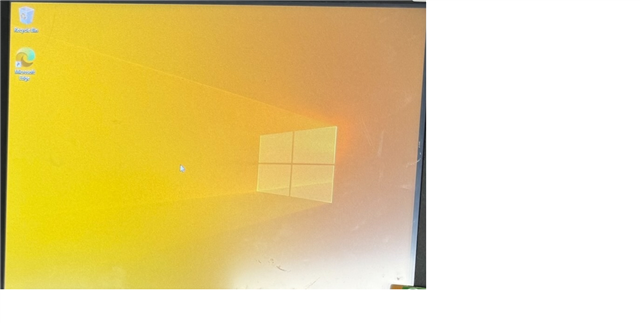

We tried to use 949 to connect to 928. The screen can be displayed now, but there is a problem with the RGB screen (such as the attachment). Do you need to modify anything? The hardware design is in the previously provided pdf.

Johnny,
This looks like a MAPSEL issue to me. All you should need to do is to flip the MAPSEL setting on 928 since 949 only has one possible color map setting.
Try setting 928 register 0x49 = 0x40 or 0x60 and you should be able to resolve the color issue with one of those settings
