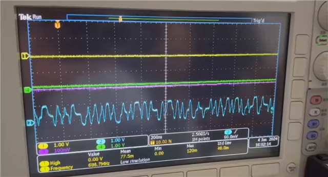

we mesure the waveform during autonegotiation phase and did not find anything abnormal obviously

This is the waveform from the network switch with cable not connected to our device.It is fast network idle
after connect the cable with our device. the waveform come to be something showed in the video

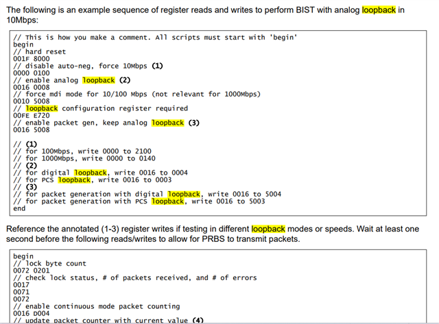

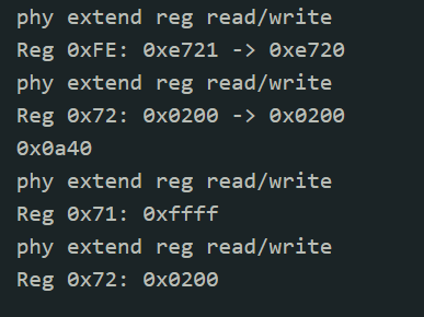

    Update :we tried loopback mode to see if the internal path is okay with the cable connected with the switch, and the 100M analog loopback works well.
    May this will help find root clause.
  • Hi Min,
    Thank you for all of the register data. I am not sure what the issue is here and need to consult further with my team.
    Regarding your loopback test, I'm glad that this works but it does not help debug the current issue. Analog loopback takes data received from the processor and send it back to the processor. This confirms that the MAC Interface connection is functioning.

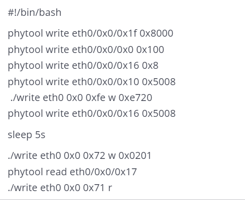

    As a complete shot in the dark, attached below is a script meant to improve performance when using short cables. I am unsure if this will help your case.
    begin
    // Hard Reset
    001F 8000
    // Threshold for consecutive amount of Idle symbols for Viterbi Idle detector to assert Idle Mode
    set to 5
    0053 2054
    // CAGC DC Compensation Disable
    00EF 3840
    // Master Training Timers - increasing time in different training states
    0102 7477
    0103 7777
    0104 4577
    // Timing Loop Bandwidth
    010C 7777
    01C2 7FDE
    // Slave Timers - increasing time in different training states
    0115 5555
    0118 0771
    011D 6DB2
    011E 3FFB
    01C3 FFC6
    01C4 0FC2
    01C5 0FF0
    // FFE Fix
    012C 0E81
    // Soft Reset
    001F 4000
    end

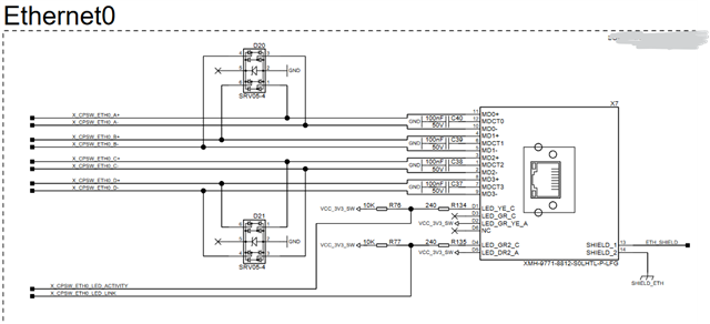

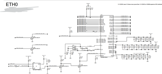

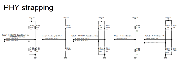

    Would it be possible to share your schematic?
    Alvaro
  • Hi Avrao,
    Let me share eth related schematic
    Min
  • Hi Min,
    Please find the schematic review attached. I didn't see anything obviously wrong with the schematic that would contribute to this issue. Regarding the magnetics, would you be able to provide the data sheet for the XMH-9771-8812-S0LHTL-P-LFG Magjack component ?
    DP83867_Schematic_Checklist_PHYTEC.xlsx
    Alvaro

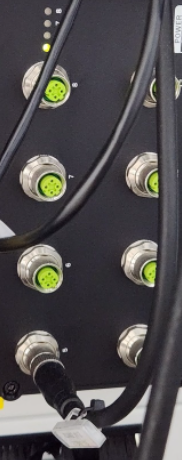

  • Hi Alvaro,
    yes, they only have issue with the custom switch and are able to link up with other patner like the PC hosts. The custom switch has his own special cable which is 2-pair wtisted wire with the kind of interface like the picture below  as one end. These are the interfaces on the custom switch.
    Min
  • Hi Min,
    Thanks for the picture, please allow me to review again with my team.
    Alvaro

  • Hi Alvaro,
    we only use the cables showed with the picture before to connect with the network switch, the cables are provided by our customer, the have different length(2-10m) of cables of this type. The end near the network switch is shielded but the end near our device is unshielded. Our customer has a coverter cable to connect the shielded and unshielded side.
    The phy and soc are very close to each other, so they both get cold and hot, we can not identify. But all the temperature falls in the normal working temperature range of our system on module.  And update: we test another network switch from the same vendor, all the boards including the cool working board fail to connect.
