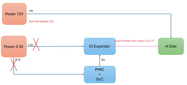

Hi, Clemens
here is our client function block as below chart:
if power 3.3v suddenly shunt down, I/O Expander(TCA9539-Q1) could possible have 1.2v output voltage to H side block?
if any suggestion, Please advise me.
Lawrence
Hi Lawrence,
Please see this e2e.
I think it covers your question. I don't suspect back-biasing to occur through the IO when powered-down on VCC.
