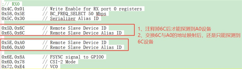

Baolong met a problem when configuring 935+960. Could you pls help on this? Thanks!
1. After mapping two sets of I2C (6C and A0), only the sensor address 6C is recognized, and the E2PROM address A0 on the camera side cannot be recognized. Only after commenting out the sensor's I2C address mapping 6C can A0 be recognized.
2. After swapping the address mapping of 6C and A0, still only the 6C device can be detected.

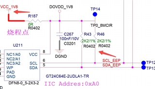

    1.There are two devices connected to the I2C bus, namely the Sensor and the E2PROM. The address of the Sensor is 0x6C, and the address of the E2PROM is 0xA0. Their addresses do not conflict.
    Our configuration is as follows.
       0x5D,0x6C         // Remote Slave Sensor Device  ID
       0x65,0x6C         // Remote Slave Sensor  Device Alias ID
       0x5E,0xA0         // Remote Slave E2PROM Device ID
       0x66,0xA0         // Remote Slave E2PROM Device Alias ID
    2.Also, we have checked the hardware, and the I2C is pulled up to 1.8V with a 2.2K resistor.
    My question now is why the I2C addresses of the two devices can't be mapped simultaneously. Is it necessary to configure other registers?

    If your system has the I2C master attached to the DES, i.e. looks like this: Imager / EPROM <--> SER <--> DES <--> SoC (I2C master), the only configuration you need is to define the IDx and Aliases on the DES as you are doing, and enable I2C Pass-Through in reg 0x58.
    There are no other configurations needed from our side.
